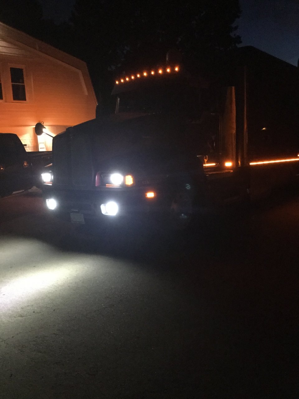

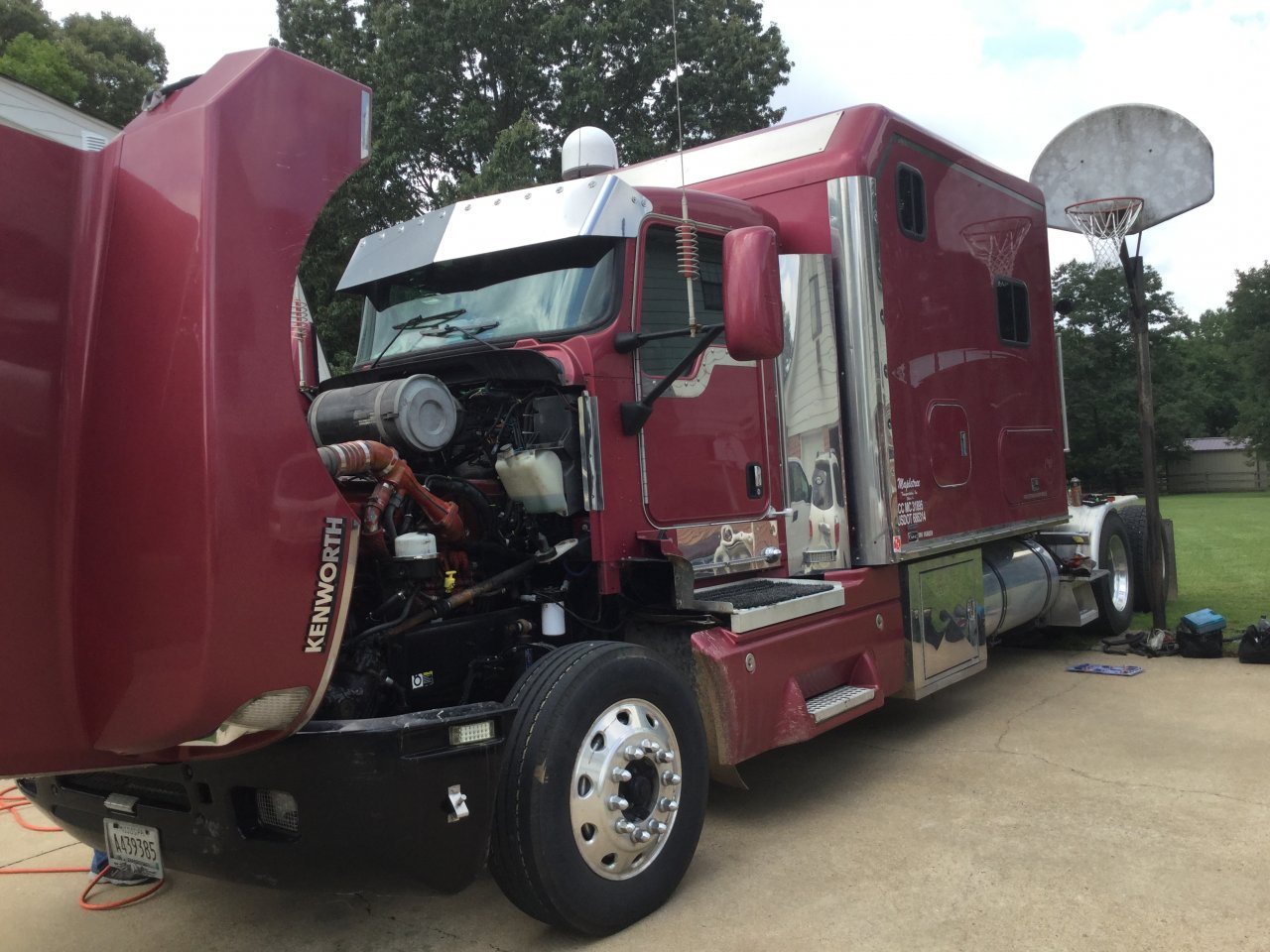

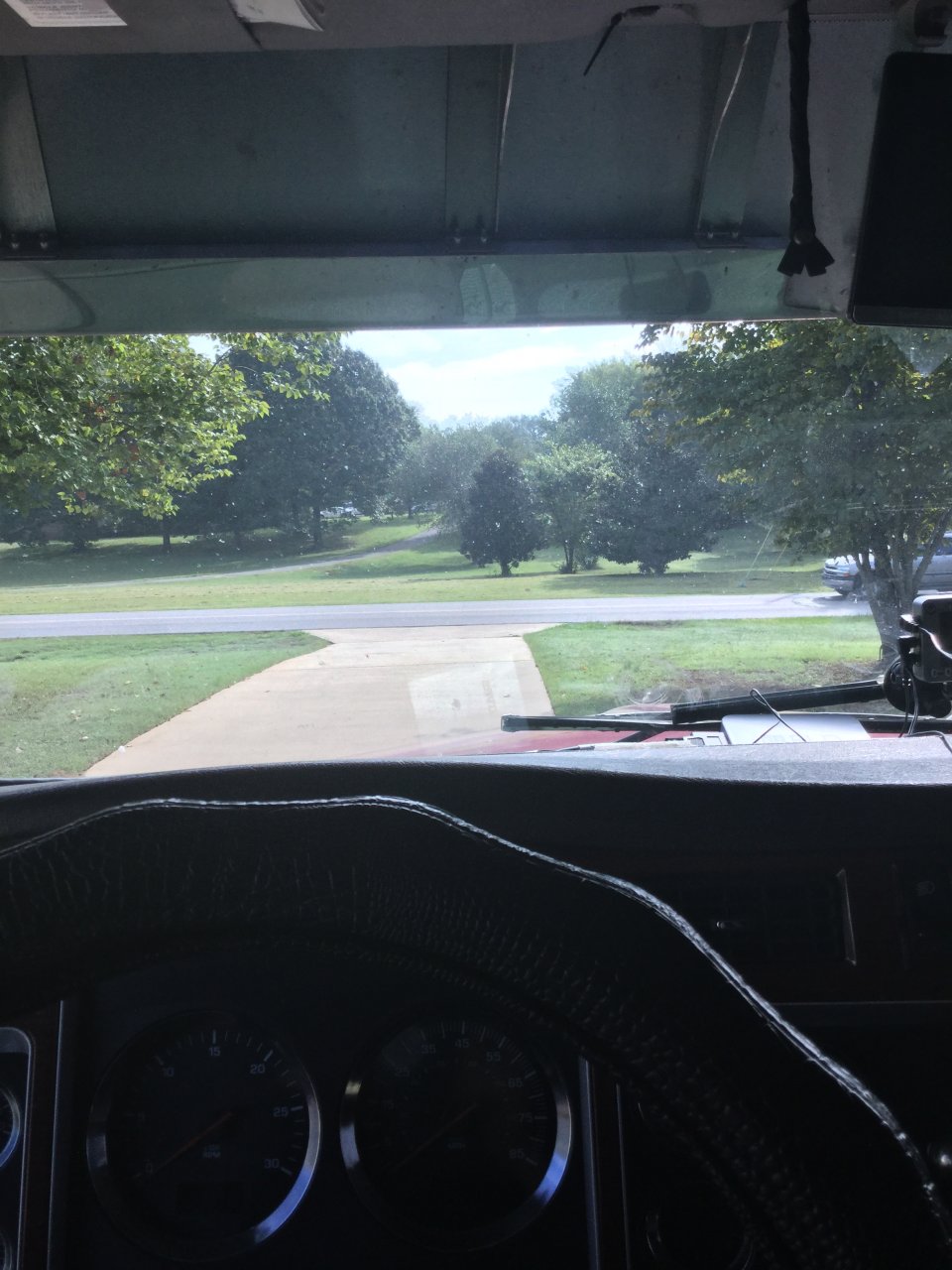

    We put that on my dad’s t600. It comes in two pieces. You bolt the two pieces together in the center. You have to drill holes, tap in the rubber well nuts and tighten the bolts where they expand and seal up. We also put a clear silicone around the holes and there has been no leaks.
    It comes with a center brace to put against the windshield with rubber feet, but we didn’t put it on. It doesn’t hardly flex in the wind. It’s a quality piece.
    Where the ribs are is where you drill the holes in the roof, it’s simple.
    Lit up at night

    You can see in the pic with the hood popped there is two bolts above the door window. So you drill two there, two on the passenger side, and I think about eight across the top where the blind mount bolts are on the brackets. The truck is headed to Illlinois or I would get a picture.
    We really didn’t want to drill a lot of holes either but they sealed up and the clear silicone works well. No leaks, still solid, and no more need for sunglasses.
