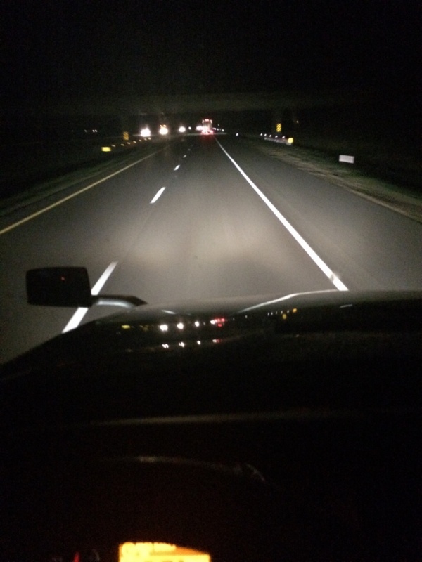

This kit came with canbus harness.
When check light comes on,all i need to do is either restart the truck or turn lights off and on,and it will go away. -
