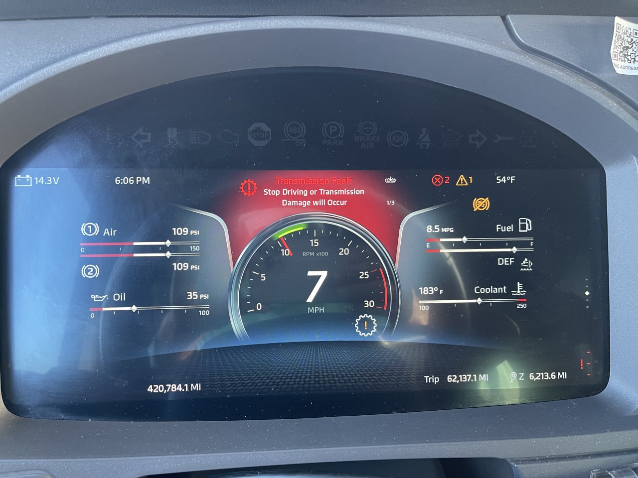

    My truck started having same problem when in manual mode gear shifting. I have kenworth 2022 t680 cummins 420K miles. Did you find any solutions? Please share with us.

    Hey man sorry for the late response
    No I didn’t find any solutions for this problem the dealer changed the shift stalk like 3 times nothing has changed I am now on 350k miles still experience same problem I at this point I just gave up kept driving but lately problem has gotten worse it won’t go into reverse sometimes couple of times I got stuck in middle of stuck stops trying to back into a spot cuz the ####er won’t go into reverse ####ing nightmare ‍♂️‍♂️
