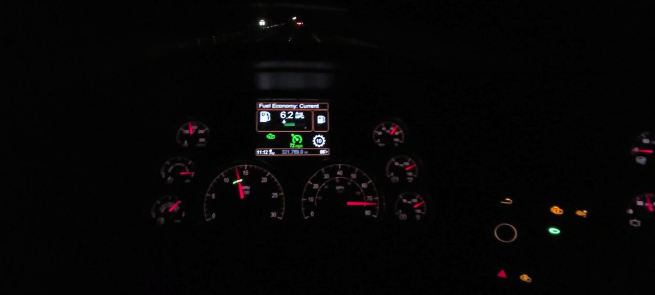

  6. Lysdexis
    Lysdexis Road Train Member
    4,484
    47,959
    Oct 25, 2018
    This is actually the best economy I've been able to get. VideoCapture_20200610-230958.jpg
