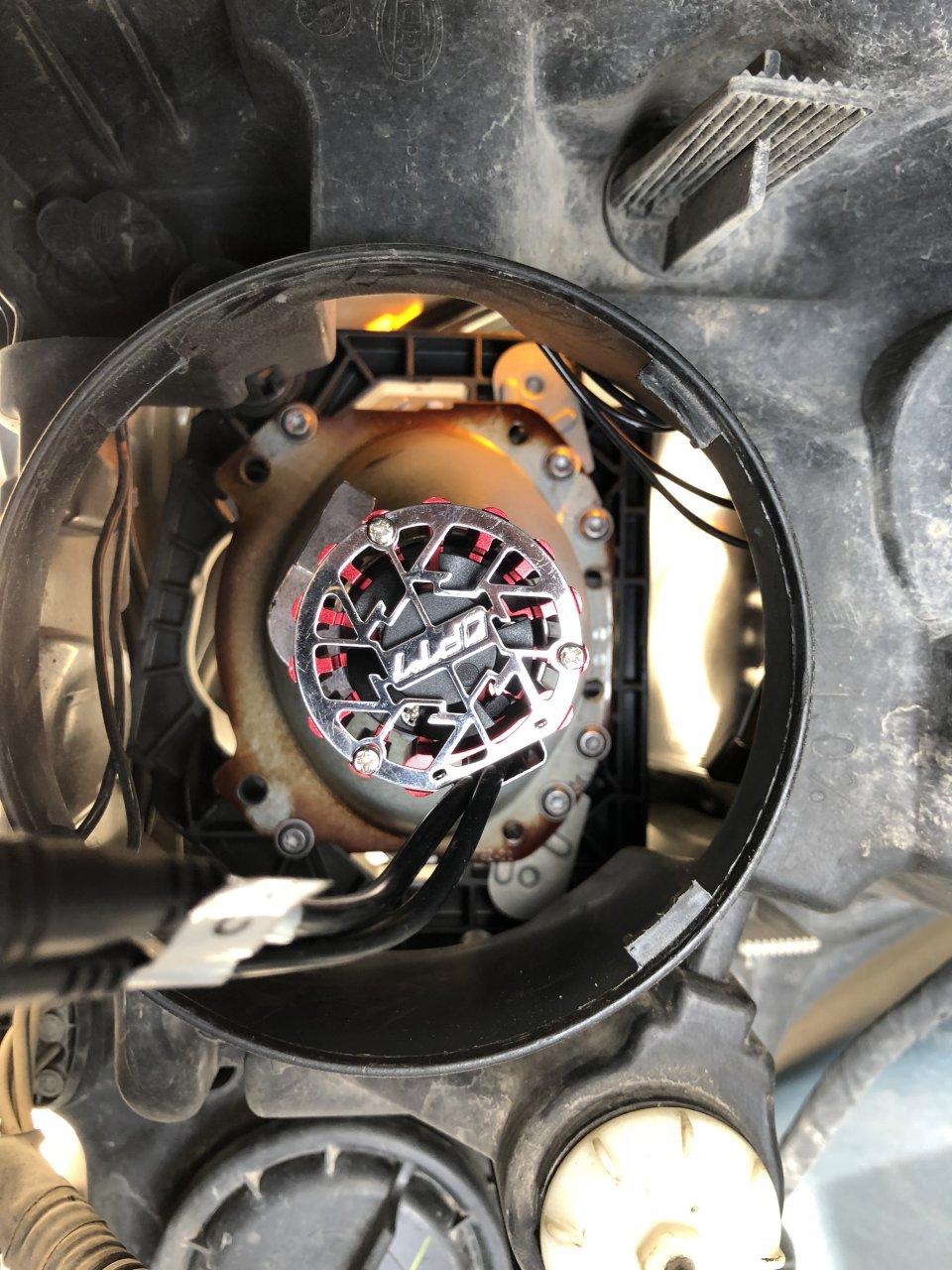

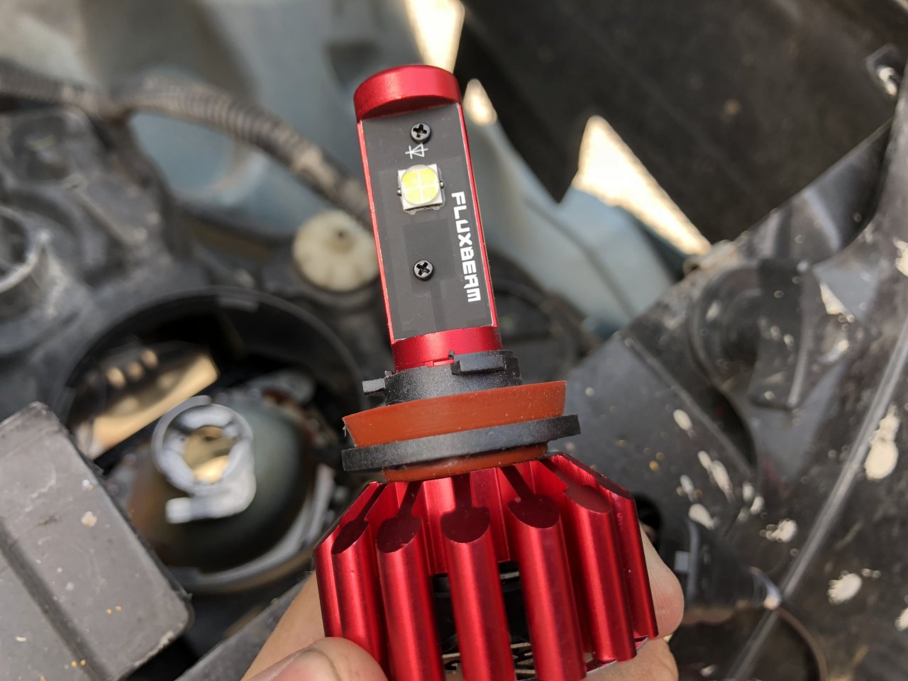

    Yes and I put OPT7 Flux Beam X in and they run cool and give better lighting than what I was running.
    I didn’t change the bucket out because the sockets for the OPT7 didn’t quite fit so I either had to bend the prongs on the bulb inward or the truck socket outward. Since I already had the socket removed on the one bucket and connecters spliced in it was very easy to hook up the bulb. I’ll get pictures as soon as I can.

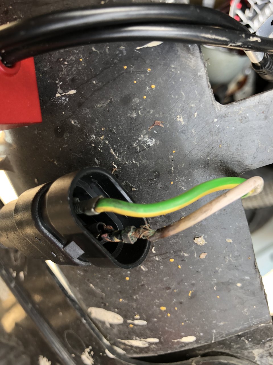

    as for your wire burning issue, put a multimeter on it and measure resistance, I bet your over 1ohm on that ground which is why it keeps melting.
    SAR and 25(2)+2 Thank this.

    Replace the connector and terminals with a Motorcraft Pigtail kit, WPT 1497 (HU2Z-14S411-KA) which has silver plated terminals and 14 gauge wire which can handle the high heat this bulb generates and overheats the terminals causing spread, loose terminals.
    25(2)+2 Thanks this.

    The OPT7 led bulb setup has stopped this melting issue. I don't know why or how but maybe cheap quality bulbs from truck stops are just garbage? These LEDs are great, haven't had a single issue yet.
