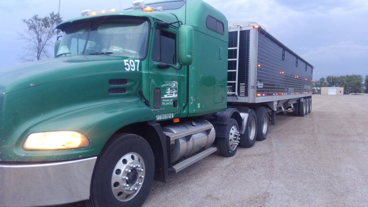

    2017-06-27_09-18-41.jpg they are for extra weight. for general otr freight i don't see a reason to have one unless you are doing permitted heavy haul loads.
    i have one but i run in a region that allows greater than 80klbs on divisible loads with my axle spacing i am allowed 42,500 lbs on my drive axle group with my pusher down. light loads or empty i can lift it and only have 2 rather than 3 axles on the ground in my drive group.
    my gross weights legal can range from 92k lbs (with shorter 3 axle gravel trailers) to 96k lbs with the trailer pictured and 105,500 on seasonal permits. thoughs are the legal weights with taking a tape measure to everything i have rolled threw the scales at 98k without the scale master even blinking a eye at me
    i have permitted a 118k lbs gross non divisible load using my truck once. to move a excavator for someone using there trailer due to there tri axle truck being broken down and they would not issue the permit on a tandem.
    honestly if i was going to go to hauling dry van over the road i would probably remove my pusher axle. the axle assembly weights about 1500 lbs dead weight if your not going to be using it.
    the problem with trying to run this setup otr is every state has different rules, regarding gross weights, interstate vrs state roads max gross weights how they calculate gross weights permits required ect and then some states that are 80k lbs max. like nd has one formula for gross weight for state routes another for your interstate permit then mt has a different way of calculating there allowable weights, then sd is similar to nd's state route calculation but they have no max gross limit, its entirely determined by your axle groups/spacing. i also run in canada and they have a totally different way of calculating there weights.
    if i were to go into mn i can get a permit for slightly higher weight on state routes but there is no permit you can buy for interstate routes.

    96k gross with a tall sidewall temptie tri axle trailer and my truck is a 64k lb net load or 73k lb net load on a winter or harvest permit for 105,500 gross.
    my gravel trailers come out to around 28 ton net load.
