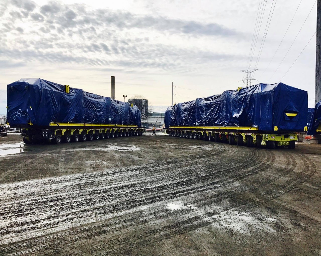

  9. 4mer trucker
    8,777
    272,560
    Nov 18, 2015
    Holy Cow they're huge! Counted 18 axles
    How many tires are on each axle and are the Platforms self propelled or pushed / pulled by Tractors?
    Are there more Platforms off to the Right of Ur picture?
    johndeere4020 Thanks this.

    I've seen some of the videos, puller couple pushers.
    Idk enough to know how many wheels go across or if the wheels have propulsory power.
    4mer trucker Thanks this.
