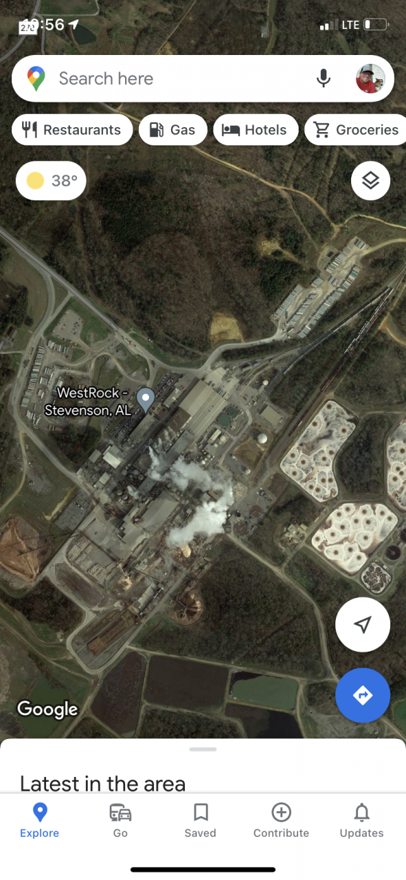

    Where did this happen at? I’d like to see the satellite view. If this is really a genuine question from someone with the stated driving experience then I would truly like to help and offer suggestions, if only to save my hood at a truckstop down the road.

    Westrock in Stevenson, AL

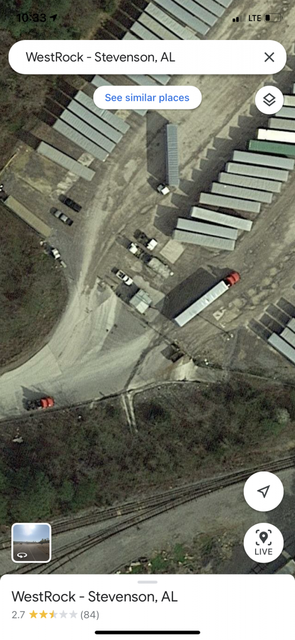

    Agreed. But I still don't see how he had an issue to begin with. If he'd stayed tight to the right. Heading straight out of the exit. Till he was almost to the red truck. His trailer should have been behind his truck by the entrance.

    I believe that there are multiple guardshacks with multiple drop lots at Westrock in Stevenson. That might or might not be a photograph of the guard shack I was at. One difference between the scenario in that photograph and the scenario i was in is that there were multiple trucks in line farther to the east than the one parked bobtail tractor in that photograph.

    There was a long line of tractor-trailers much farther to the east when I was doing my U-turn.

    The other drop lot doesn’t match your drawing at all. Either way, I would’ve found another place to turn around. That’s just me though, I don’t like making right u turns. Best of luck in your continued trucking career.

    Still doesn't change the mechanics. You just had to wait your turn. Or do the smart thing and drive 100 yds further. Where there was plenty of room. Years of experience should have made that clear.
