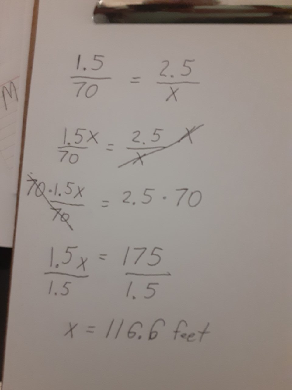

    I used your photograph in post #45 on this thread and a ruler and some algebra mathematics to calculate the forward space to the south in front of the guard shack at Westrock in Stevenson, AL. When I am talking about forward space to the South in the photograph, the South means the bottom of your photograph, not the direction south on a compass. I used a ruler to measure the length of the tractor-trailer on my computer monitor. The length of the tractor-trailer in the entrance lane in the photograph is 1.5 inches on my computer monitor. I estimated the tractor-trailer to be approximately 70 feet long. Then I measured the forward space to the South in that photograph from the exit (lined up with the guard shack) all the way to the curb. The forward space to the South from the exit to the curb was 2.5 inches.
    Then I used algebra to calculate the forward space from the exit to the curb. The forward space from the exit to the curb is just under 117 feet. But there was a line of trucks taking up part of the forward space to the south. I estimate that line of trucks would remove about 12 feet of forward space. So I had approximately 105 feet of forward space to the South.
    here is a photograph of the mathematics:
    105 feet is not that much! I didn't have all that much space to the SOuth. I don't think I had enough space to do it all without a back before I moved forward through the entrance gate.
