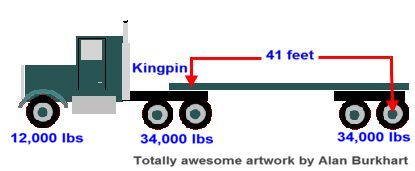

    Here is a basic diagram. CA is the strictest with the rule and it's really not a "bridge law" per say and they will typically allow one hole +/-. And also note this is not the forward most position on most trailers.
    Raycubed Thanks this.

    Don't completely trust the Rand Atlas. They still show no limit for PA. But it is 41 feet to the center of tandems.

    So, just making sure i have this right. I put the 41 Mark right in the middle of the tandem between the two axles?
