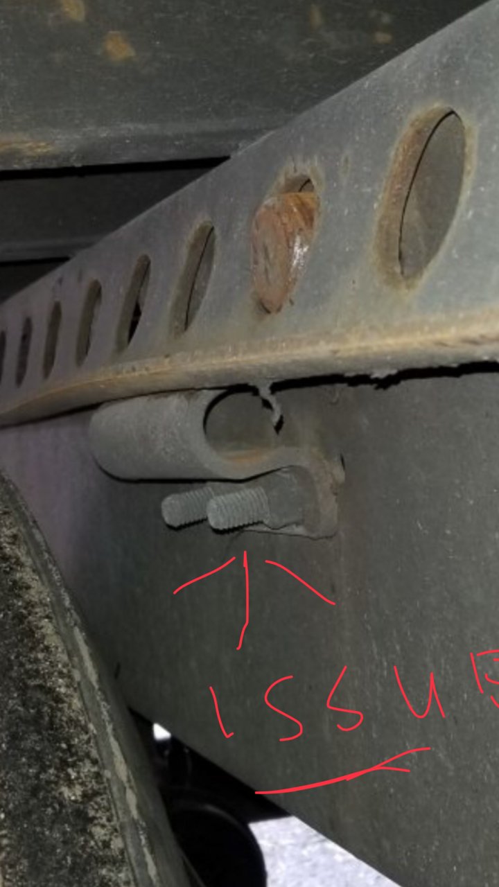

    Here in Canada it is 75% or more. So 3 out of 4 puts you at 75% therefore out of service. Every word is put at the right place!

    Pins are the least of your worries the whole chassis will pull out from under the trailer under hard braking it’s jumped the lockdown clamp.. that’s why the pin won’t go in

    the tandems have been known to slide off before trailers don't bounce very well,

    The pins have very... Very minimal Spring pressure behind them to seat. No worried my friend!

    This trailer needs to be placed OOS immediately!!! DANGER !!

    This is safe compared to pics drivers have shared here in the past.

    Short answer, Yup. easy to fix though

    9F37A23D-4007-4FF2-97E4-3E633771C487.jpeg trailer isn’t being held down onto to chassis other than by pin pressure
