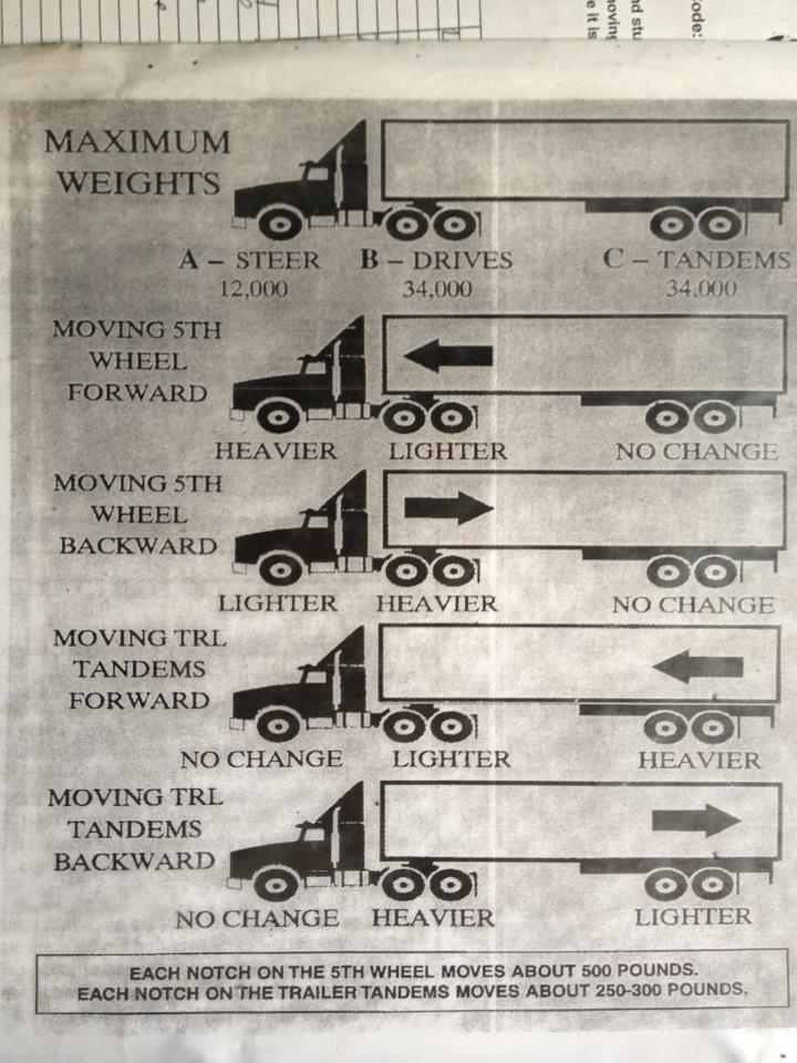

    Maybe you should have taken your training as seriously as Dana did.
    Move the axles toward where you want the weight off, guesstimate 250-500 lbs per hole moved. After you've done it a few times you'll have a better idea how much weight is moved with each hole.
    For future reference, when some one more experienced than you speaks, listen. You have a history of bashing your trainers on these boards and here we are 10 months later.

    To the original poster, if the gross vehicle weight is over 80,000 pounds, call dispatch and have the shipper remove some weight. There is nothing you can slide that will fix a vehicle that is over 80,000 pounds.
    .If the steer axle is 12,000 pounds or less and the gross vehicle weight is under 80,000 pounds try the following:
    . step 1 take the trailer tandem weight and subtract the drive tandem weight that is the difference between the two.
    .step 2 take the difference and divide by 500. This gives you the number of holes to slide the trailer tandems.
    .step 3 Slide the trailer tandems. If the answer is a negative number then shorten the trailer wheelbase by sliding the trailer tandems that number of holes. Otherwise, [positive number], increase the trailer wheelbase by sliding the trailer tandems that number of holes.
    .step 4 re-weight the vehicle.
    .step 5 determine how much weight was moved and divide by the number of holes that you slid the trailer tandems. Now you know exactly how much weight each hole moves on that trailer.
  11. STexan
    STexan Road Train Member
    14,963
    29,178
    Oct 3, 2011
    Longview, TX
    A little tip ... Post #29 is "generally good" for rule of thumb but by no means should be considered the end-all be-all method to guarantee success because the 500 number may in reality be 250 or 650 depending on load configuration, and it does't take into account the current fuel load (You may want to not equally spread the weight, drive to trailer)
    But enough about that. For any mental sliding method to work, one first has to make a note of the original hole position number you're starting from and not just willy-nilly slide around. I mean, you can I suppose if you want to spend 30 minutes wearing out your clutch. BTW, how do guys with autos slide a difficult, heavy slider, anyway? Must be a PITA
    You can physically COUNT the holes (I don't recommend this personally), or you can take your ball peen hammer/tire bumper [you should have between your seat and your door] and "scratch" a mark at your target hole (after you've done the mental estimations in your head based on what the current weight numbers say) The road grime/dirt underneath the trailer insures it's easy to scratch a target mark for easy and positive reference rather then getting cross-eyed trying to count holes, or burn an initial image into your brain that may or may not stick.
    I've seen guys spend 2 minutes counting holes, determine they want to move maybe 3 holes, then slide forward maybe eight, then back maybe 2 then go back and count all over again
