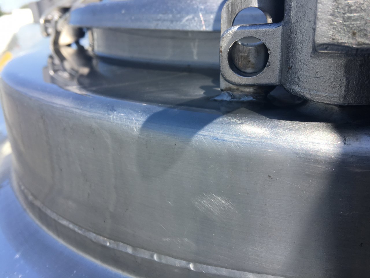

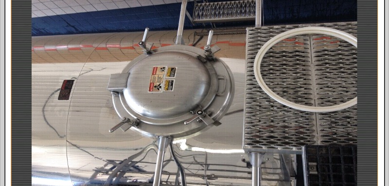

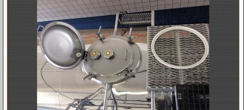

    I've been driving a tank for three days on very limited training. The only thing they have shown us about the dome are these 3 pictures. We don't pump all we do is drive and check seals. The shipper/cons seal the trailer and pump.

    When dealing with the 5th wheel I noticed a half dollar sized puddle and few drops rolling off the tank. Visually inspected the dome and ran my hand around the gasket. The gasket was intact but two of the screws could stand to be tightened. I got 200 miles down the road before I ran out of hours. Parked it.

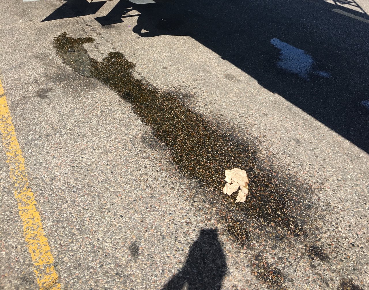

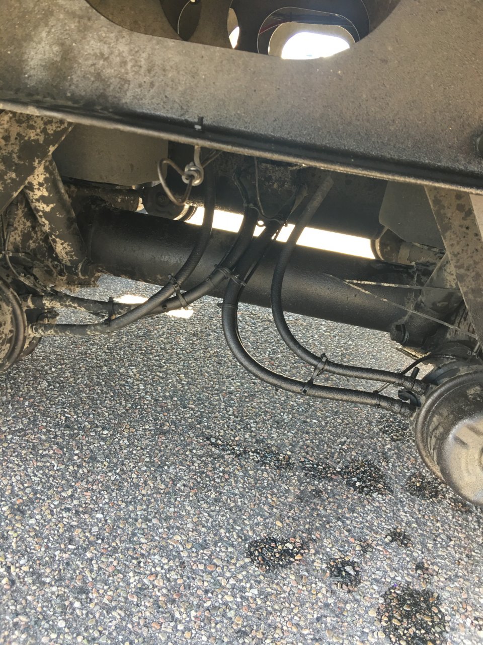

    Woke up the next morning and did my pre trip. I noticed oil all in the tandem area on the trailer and a puddle of yellow liquid. I didn't run over any road kill big enough to leave a stain like that or go thru any construction zones. So I checked my brake linings and they were clean. I looked back at the puddle and wondered if I had knelt in any of it whe checking my brakes when i realized that the surface of the puddle wasn't consitant with any water based liquid. It was oil.
    I called breakdown. Sent pictures. We agreed to send the truck to the wash because it was probably just oil that had finally pooled down from when I was loaded. I wasn't having any of the two hour wait at the beacon.
    I started to my final and stopped for a break 100mi down the road and noticed fresh oil on the side of the tank. I checked the gasket and it was wet and the screws seemed to have more space to be tightened. Realized that the gasket was leaking I called the company.

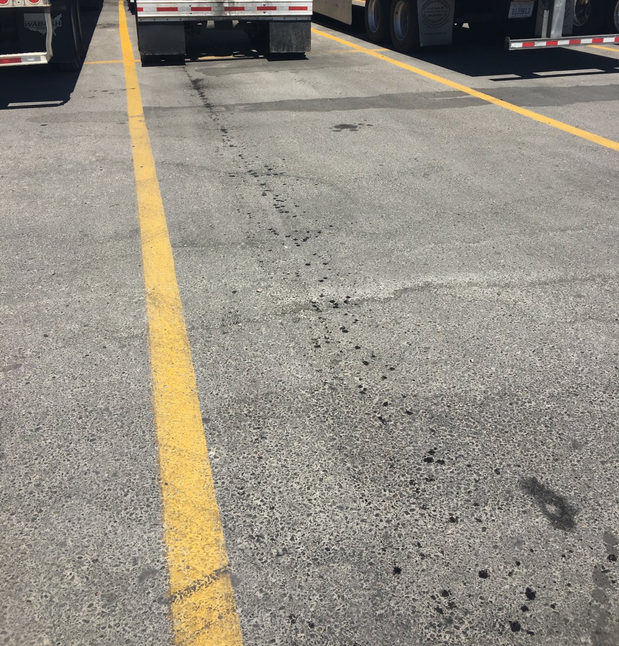

    Come today and it's like I'm pulling a whale. I have oil in my brake linings and I'm leaving puddles everywhere I go.

    As far as I can tell the gasket got sucked into the tank.
    You can see the line where it used to be. That screw thing was preventing my hand from telling me that the gasket wasn't seated properly there. On the other side of the screw thing the gasket is seated right.
    When I open the dome what do I need to worry about?
    I have no tools other than two vise grips and a screwdriver. The truck stop doesn't sell any giant wrenches. Are there any substitutes for the giant wrench this other tanker showed me?

    I know what I would do, but that doesn't mean it's a perfect solution. I'd stop just before the CA scales and clean it the best I can, then go on as the company wants you to do.
    If you can, pull into a truck wash and have the exterior of the trailer washed before delivery.

    I can't even stop or shift without it coming out of the dome whale style.
    All of that came out just from parking.

    Stop at a tank wash and have a new dome gasket installed. About a 5 or 10 minute job.
    Didn't realize that much oil is leaking. What type oil is that; food grade?

    And stuff some rags in the drain tubes tell you get past the cali scales.
    Edit: never mind went back an looked at the pics and you dont have a containment box around the dome like I do on my tankers.

    The receiver may not accept the load if the seal is broken. The seal has to be broken to replace or re-seat the dome gasket.

    It's an easy fix to re-seat the gasket. Loosen the dome slowly to ensure no pressure has built up in the tank. If you hear a hissing sound, wait until that completely stops before taking the hold down fastners off and opening the dome lid. Don't lean over the dome lid when you release the last fastner in case some pressure is still inside. Even a little pressure is enough to knock you off that trailer if the dome lid hits you.

    Thanks. So treat it like the coolant system when you need to add coolant but the engine is warm. So each fastener gets a full turn or a quarter turn? Do I have to do a star pattern as I undo them like tires?
