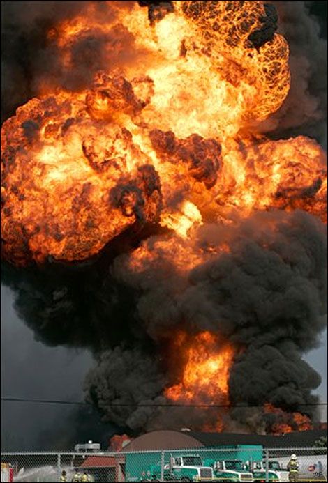

    We haul flammables. I've noticed when I am releasing the pressure the flammable fumes are coming out as well. I was thinking to myself, I wonder if the fumes could potentially cause a fire to spark. I'm just trying to understand the full process so I don't injury anyone around my trailer. My company had 2 accidents years ago where the whole plant caught on fire.

    It's possible, depending upon the concentration of the flammable vapor.

    This was the result of a spark from something catching fumes on fire
