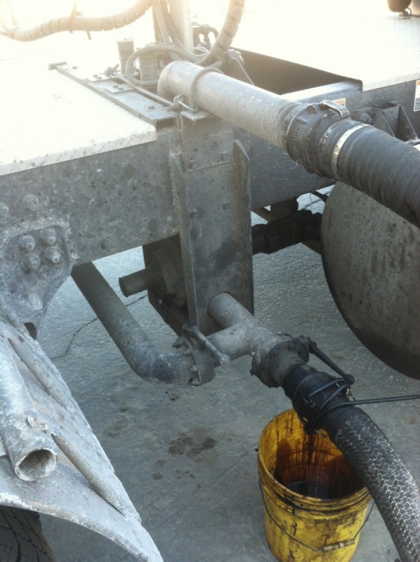

    This is a product pump. The top hose goes to the nose line on the front of the trailer. Not all trailers have a nose line sometimes you might have to lay hose to the back of the tank. Or drop the tank and place tractor behind it , to save hose....
    The bottom hose goes to cust tank.
    Always make sure you know there is enough room in the tank and its the right tank !
    After you get the hoses and valves set you engage the pump . Start at idol and check for leaks. Then I set the rpms at 1000 with this pump. It will do between 160-300 gallons per minute . Depends on product and the " push" into cust tank.
    Once you get used to it , it's ok....... How ever I know some guys that never got it.
    You can make 1 heck of a mess real fast with one of these..........
    With an air off you are pressurizing the tank with air or some other gas And you're pushing the product out of the trailer and into the cust tank

    That's the first time I ever heard of running the lines differently. The pump on our truck uses the lower pipe as the suction side and the top cross over pipe is on the pump side. Thankfully, We don't run that pump that often.. Too much work pulling pump hoses.. The gas is where its at!! :biggrin_25523:

    With the suction on the top pump cleans out better. Less retained product..... You gas guys got it easy........ Ha ha. See ya around.

    Our PTO pumps are set up inlet on top, outlet on the bottom. Just make sure you have it right. I have heard of drivers hooking it up backwards and pumping product into the tanker until it starts overflowing out the dome lid. That would be a bad day.
