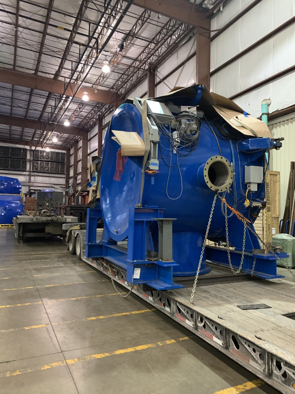

  7. kylefitzy
    kylefitzy Road Train Member
    4,754
    19,808
    Aug 12, 2007
    Kansas city,Mo

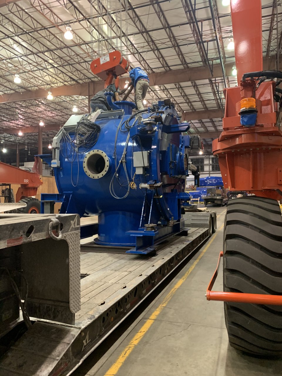

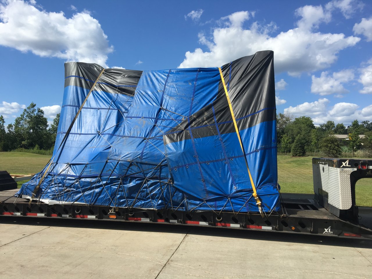

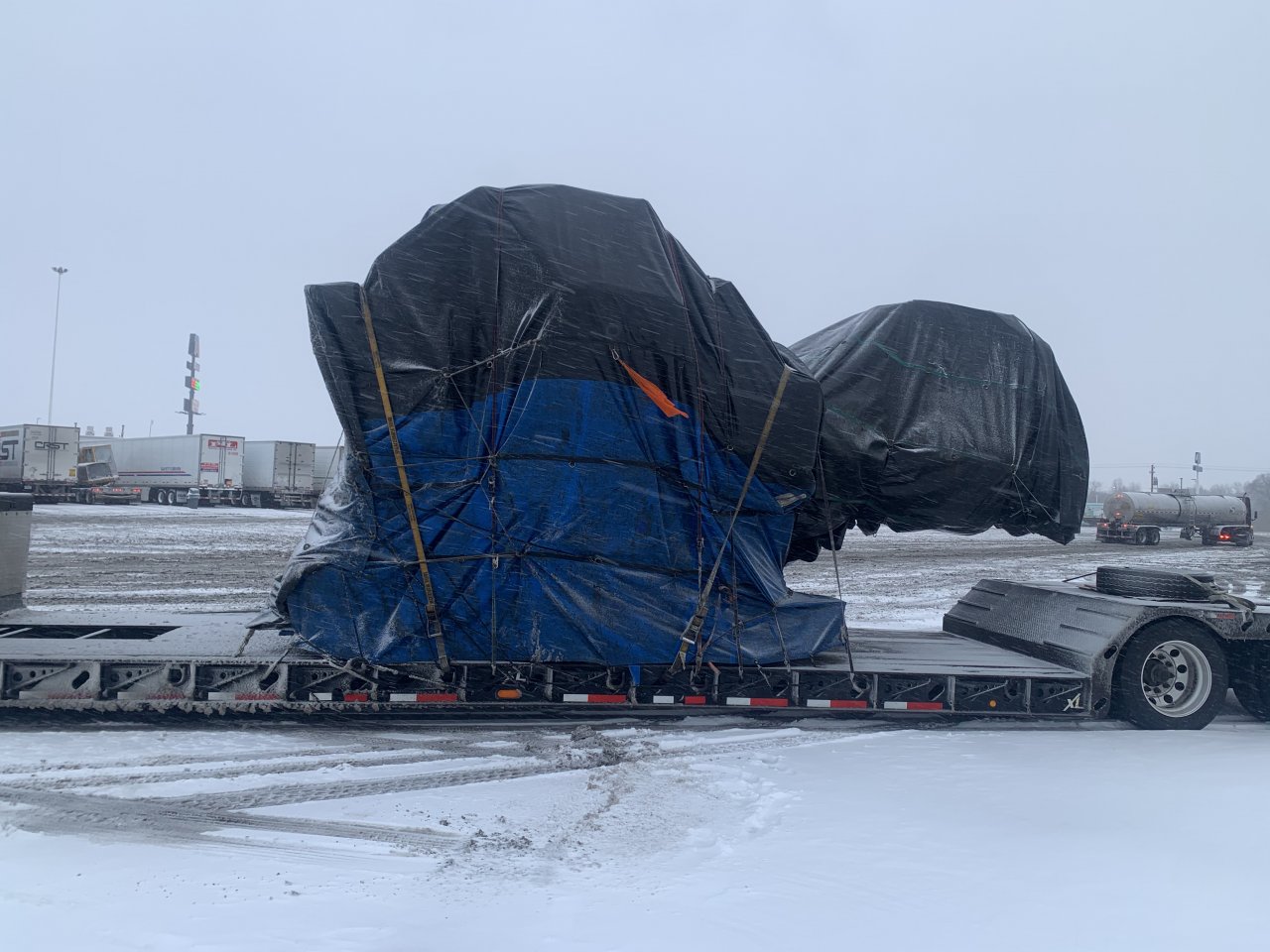

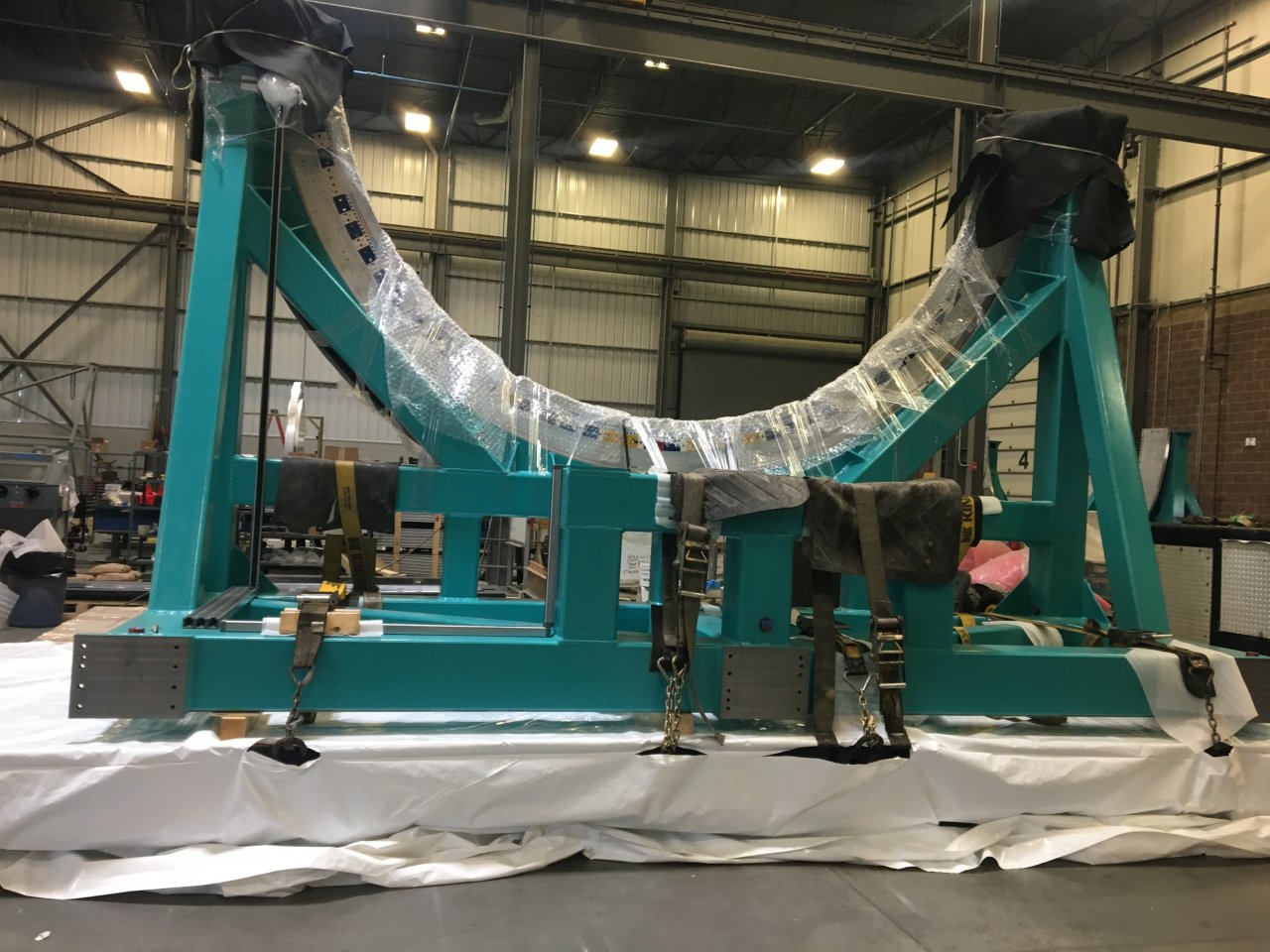

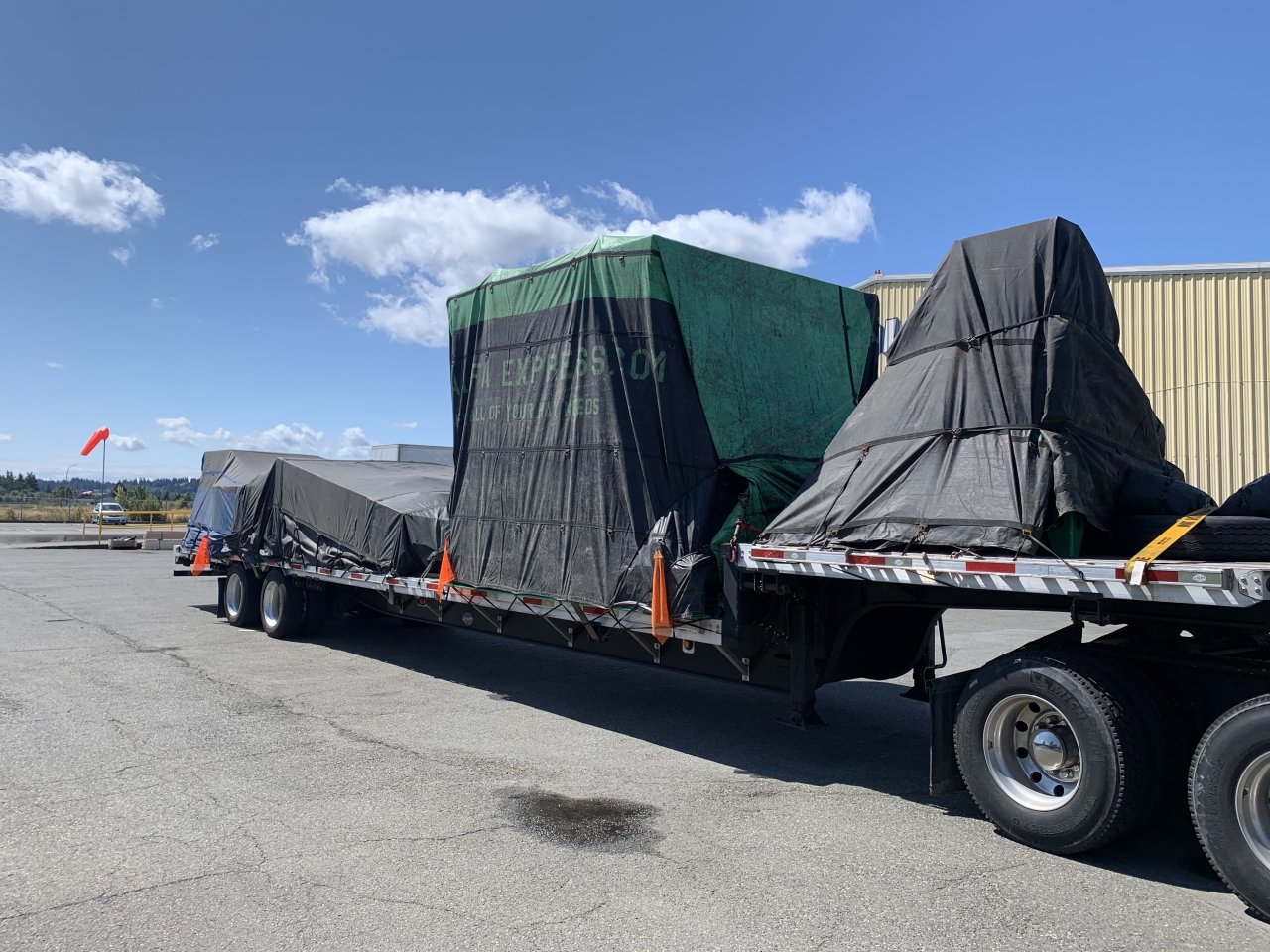

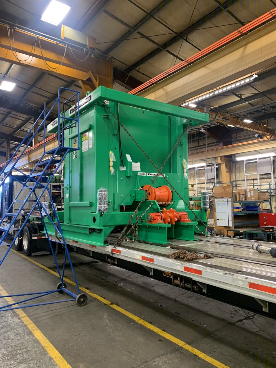

    Those don’t look so bad, if they are legal size they should be in a crate or a curtain side though. These wouldn’t fit in any we have. B99AA771-0770-49BC-BFAB-2A8591472C1B.jpeg 821F814A-490C-4A63-A08D-70EE1450B825.jpeg BDCD8EF6-EF54-4A99-9E86-3768AFC58E1C.jpeg AAAE9DA6-BB51-4CDA-8813-C6230CB314E2.jpeg 6C517EFB-6A61-4CE8-994F-C94E6D0AEACF.jpeg B6142AB0-B03F-4E06-BC01-A62AC34DF2D7.jpeg 0E9433F4-20C4-429F-AD77-2BDFF77A4E5C.jpeg

    Muchos Gracias, senor. Those are awesome photos, undoubtedly needed for load insurance purposes, but appreciated for instructional and awe value as well. :)
    I have to laugh, my first flatbed load that I had to tarp for the owner operator that wrote me bouncing checks ( :( ) was going from Michigan to Chicagoland, and the employees at the shop who were well aware I was green had a field day messing with me. Wished I could take photos back then, but it was Friday and as they all left after I was loaded and outside the building to pad with cardboard and tarp the load, they wished me a happy weekend and that they'd see me Monday. :) I wasn't there Monday, but it was a hell of a workout and seeing your stuff there I'm reminded of the fear and anxiety I had with that load and being afraid those guys were right. :)
