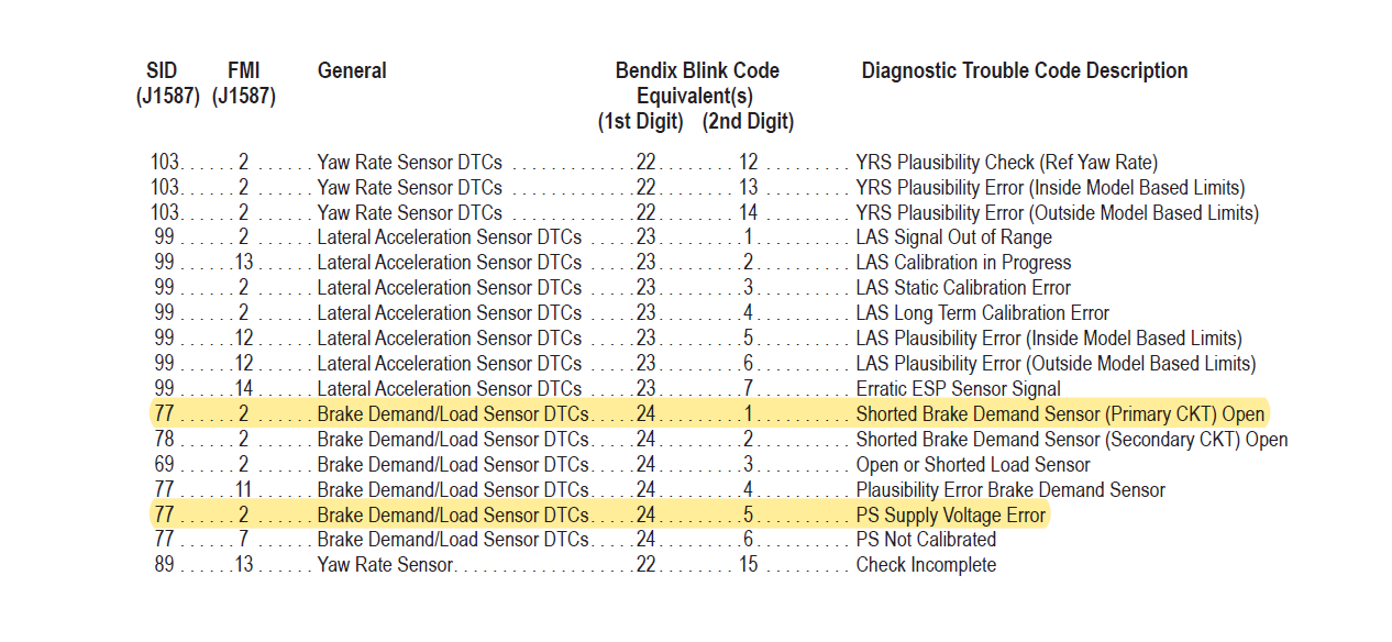

    UPDATE
    I have looked at about 6 different code charts for MID136 but none show an SID 77 code
    My Code. Is MID 136 SID77 FMI 2
    I have switched out all 4 of the load sensors under the dash
    Blew out the steering sensor ( tho could still be bad)
    Anyone show this code on any of their charts?
    Light still on

    Here is your code. By description it means signal voltage is way out of range or no signal at all. Definitely wire or plug problem.

    southbaydad Thanks this.
