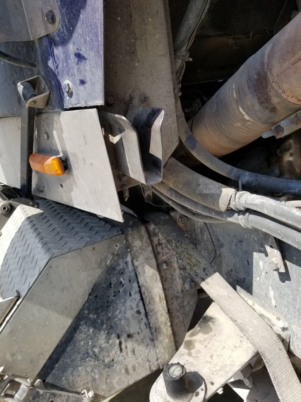

    Onto the topic, the AFB load got cancelled last night and this morning I was told to take it back to the plant to unload it back where I got it from. It was easy, i kept the psi at 15 and had two hoppers emptied in about 15-30 mins. A driver came over and chatted with me, showed me a neat trick to empty my hoppers completely and I left for Muskogee.
    Got to Muskogee at 1 and that eliminated any possibility of getting the 2nd load. So I took the one and ran. Thennn my truck started overheating. Bad. I stopped asap and put water in it, it chugged about a gallon and i started running again. And again, it got hot. So i started texting my boss, he figures the fan belts are loose and will replace them with me tomorrow night.
    I stopped to put coolant in it, and put the entire bottle in thinking "wow i'm sure dumb for running this thing empty." Only to look down and see most of the bottle is on the ground. It ran out down what I assume is an overfill hose? Idk, i'll attach 3 pics and anyone who can recognize it, let me know!
    Boss still thinks its the fan belts. They do look mighty loose.
