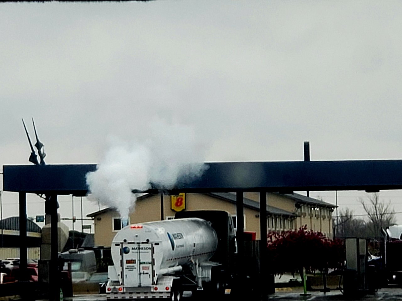

    43°, dewpoint 42°, perfect weather for a nice plume!
    He was also getting the fringe benefit of serious side eye from the clueless doorslammers who waddled past! :rolleyes:
