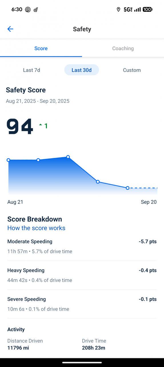

    Samsara
    scythe08, Rugerfan and viper822004 Thank this.
