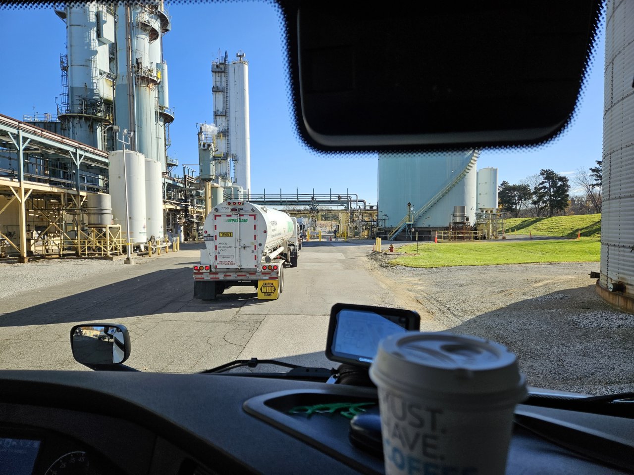

  11. Dennixx
    Dennixx Road Train Member
    4,558
    14,680
    Feb 13, 2010
    twin cities
    Gotta love this industry.
    Did 2 stops locally then headed down to NW Indiana to fill AR.
    Had time to fill but after waiting and getting on the scale to fill operator says I need to wait 1 to 2 hours.
    I ain't got time for that.
    So head to hotel.
    Come back this morning and control room tell me plant has issues, when don't they, ..and it will be 2 to 3 hours wait.
    No problem.
    Call dispatch and inform them at my 5 hours on duty mark I'm headed back to my barn. I am glad that we get compensated for the wait times. 20231109_093956.jpg
