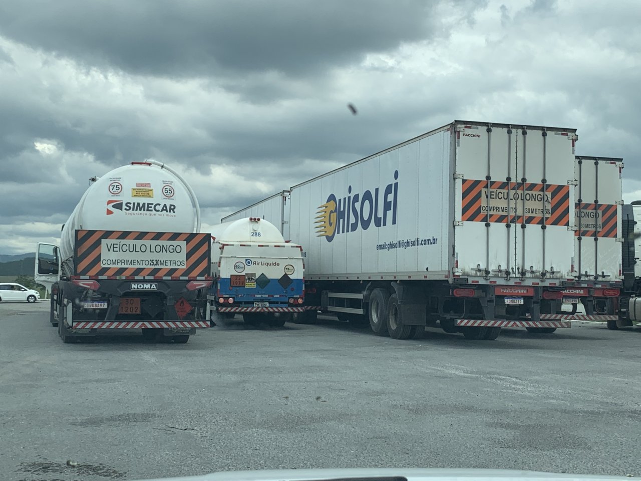

  5. 76cb550
    76cb550 Light Load Member
    98
    54
    Nov 12, 2012
    Took a picture of a Air Liquid truck in south America travels, also some cool VW's they call it FUSCA AL truck.jpg fusca.jpg
