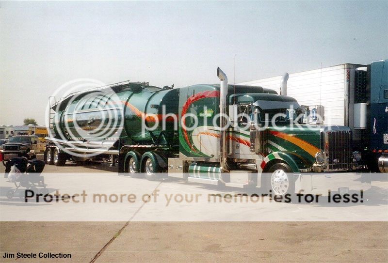

    Thanks! I also like the green on the Heil trailers. I was hauling PET plastic pellets. Check out these pictures of our companies show truck. The trailer looks really cool. Next time I see it in the yard I will have to get a better picture of the trailer. That is the same truck in both pics. Just different paint jobs

    Wow. What a classic. I can only hope that someday I can drive a rig like that. One of these days I won't have to make so much money (when the kids start school) and can take a pay cut. All of the show like trucks in my area are low paying bc the driver pays for those rigs ultimately. So cool
