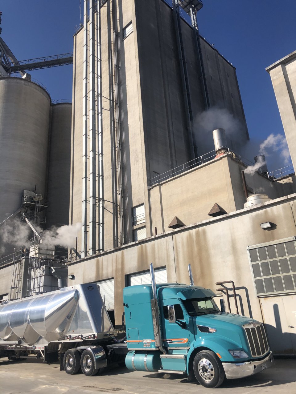

    ####, that's a long ways up on its own, not to mention the 2 horizontals and a 90. What pressure are you unloading at, I've never dealt with salt.
