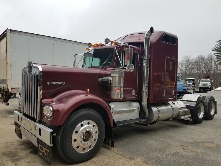

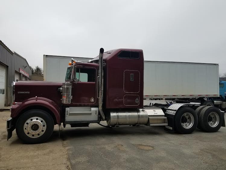

    Pretty excited for an older fella yesterday. We made it road worthy for the first time in two months, and I duct taped a piece of poly over the big hole and drove it about 15 miles north to the guy that painted the bunk's shop, so he can paint the back of the cab over the weekend for me.
    Then Monday morning about a mile from there, we are picking and setting the bunk on the truck (finally) with a wrecker at another friend's shop, so we don't scratch it with the forklift as we have been using to do it for the dry fits. Then...I drive back to the shop where I did all this and tie all the loose ends together, like put power to the bunk, put the boot in the opening, etc.
    Put stainless air cleaners on her yesterday...That woke it right up.

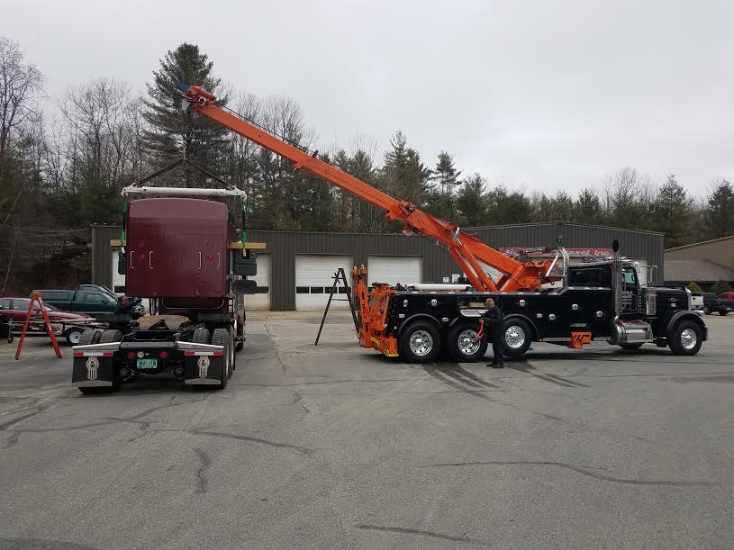

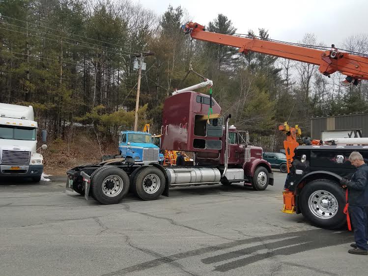

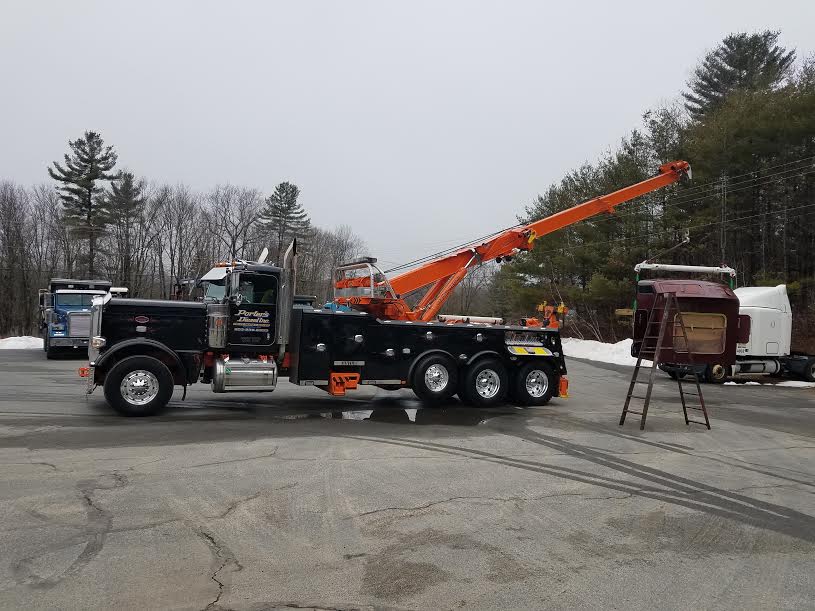

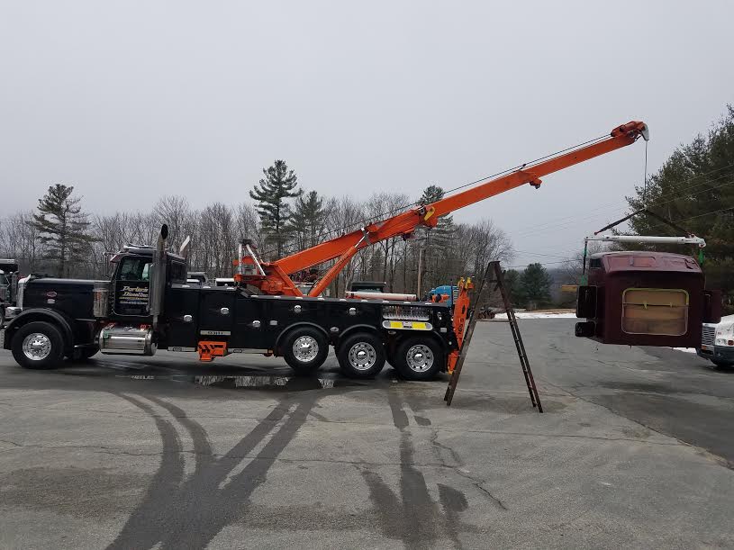

    Tuesday 3-28-17...bunk mounting day...40 ton rotator with a spreader bar made this a real simple deal. One hour and it was on.
    sleepermount#1.jpg sleepermount#2.jpg sleepermount#3.jpg sleepermount#4.jpg sleepermount#5.jpg sleepermount#6.jpg
