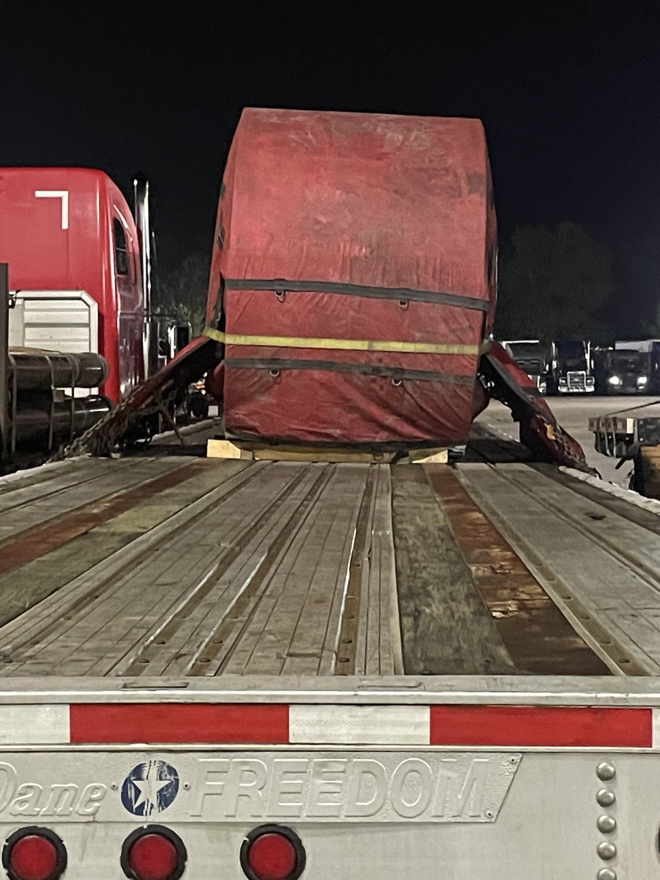

    Don’t know how well the picture portrays it but the coil is leaning pretty good to the passenger side, is off center by a good 8”, and there’s only 2 coil racks for this coil which looks at least 40k lbs

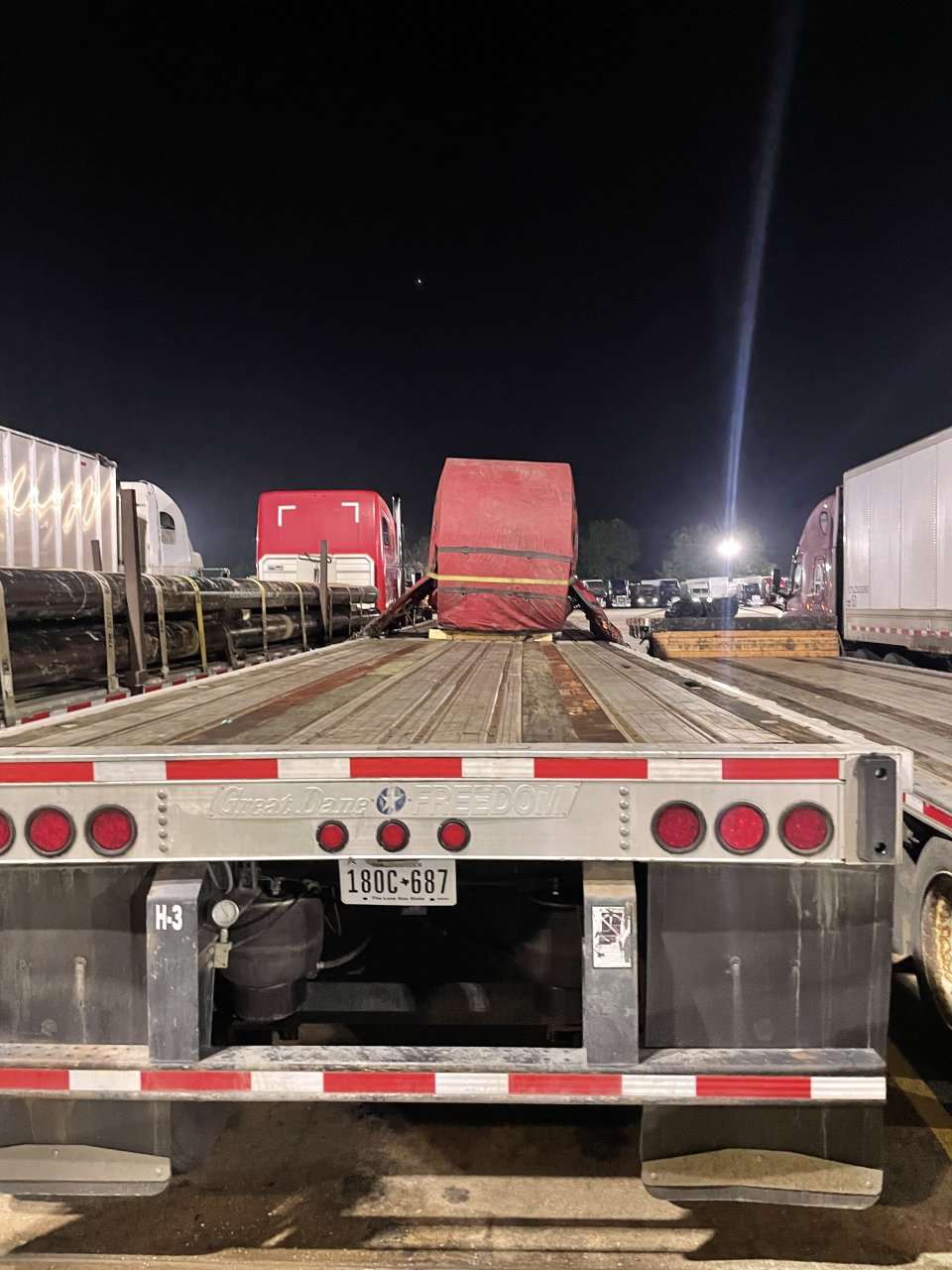

    And look where he placed the racks. Not on the frame rails. All the weight is setting inside on the floor. Few pics from 2 weeks ago.
    Idk who teaches these guys, but one day they will question why their trailers don't hold up long. I wish I had taken a better picture of that GD. Looked like the center 4' of trailer was about to exit. Looked bad from a distance.

    No friction mats or belts and not enough racks.

    You call a tow company with a rotator or a crane company that can lift the coil and reset it.
    Here is a good example of what shortcuts get you. Saved what, 5 maybe 10 minutes getting set and loaded. That shortcut will cost a few grand to fix.
