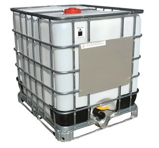

    Dry vans I feel bad for. I’ve seen eye to the sky coils loaded in them. Even train axles and wheels attached. I’ve seen raw steel, and even lumber loaded. Also those IBC totes full. There’s no way to secure them probably.
    All to save a buck since it’s cheaper than flatbed.

    Most things I can secure properly - provided they're loaded properly. Wheeled vehicles need wood chocks nailed into the floor, coils need e-bracing for the pallet and straps fore and aft to cradle the coil, totes/gaylords need a good loading plan.
