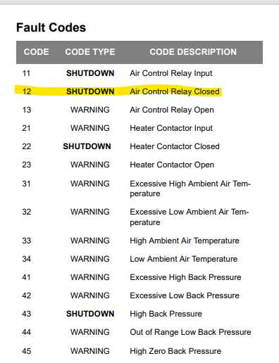

  3. JB7

    What about warranty? You have code 12.

    Pretty sure there’s some type of warranty. It’s a Penske lease truck (I’m company). I was kinda hoping I missed something and not have to take it in.
    The code you reference: closed air line. How does one tell, and can I resolve it? Is the valve easy to accidentally move while pretripping the unit?

    Air Control Relay Closed - relay meaning electrical relay. Not sure about yours but they used to be soldered on, not like relays in the truck that can be pulled out and changed. Regen is for highway speeds for at least 1 hour. See attachment. Read it carefully. This from page 1 on the left.
    The Code 12 may be preventing a regen.

    Yes, unless you get a diagnostic manual on how to resolve the code or try the 'just answer' website. The relays are soldered to a circuit board so even if that were the problem the part would be big $$ to buy yourself. Even if you were able to clear the code it would come right back. Clearing the code is more for after a repair is made, then the code clearing process will remove the code. The code is a Shutdown code, a problem so severe that the unit should not even run. It's not supposed to run to protect the unit.
