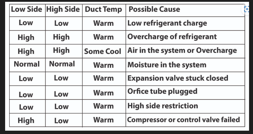

    I read a few threads on here suggesting to hookup a manifold and monitor the pressures, high side and low side.
    Here, ambient temperature is about 96 degrees and very humid.
    My low side read between 15 to 20; it stabilized around 18
    My high side read about 195.
    It ran for a few minutes like this and blew the fuse.
    To me the numbers look low pressure readings, it needs more freon.
    Also since the fuse blew when pressure wasn't even high, my conclusion is the HPCO switch is bad.
    I have not checked the switch itself for continuity.
    I also suspected a short somewhere but wouldn't that blow a fuse right away? why would it work for sometime?
    But what do you guys think?
