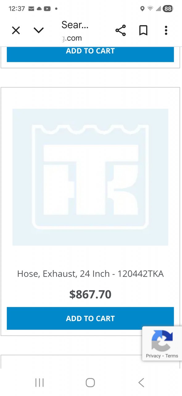

    Lol why do that when I have you all ,beside they have delivery and a very non cooperative attitude.
