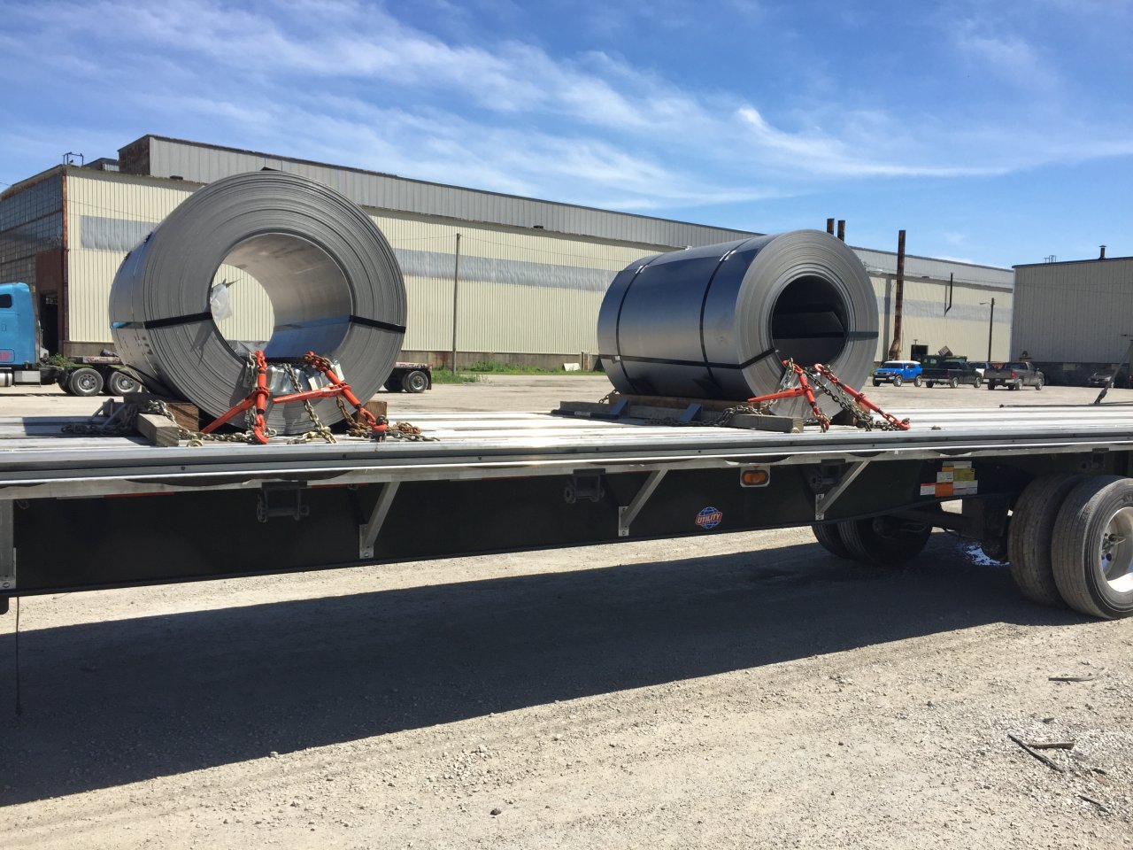

    You have to split load those old worn out trailers. I’ll do it on a new trailer too if I don’t have to tarp. CB78E586-41DC-45FB-A172-A6F9B01C346A.jpeg 4D9434EC-229A-49C1-817B-4D9B87DED01B.jpeg 6DC1D5BF-C10B-41D1-A5A2-E076A5F65600.jpeg
