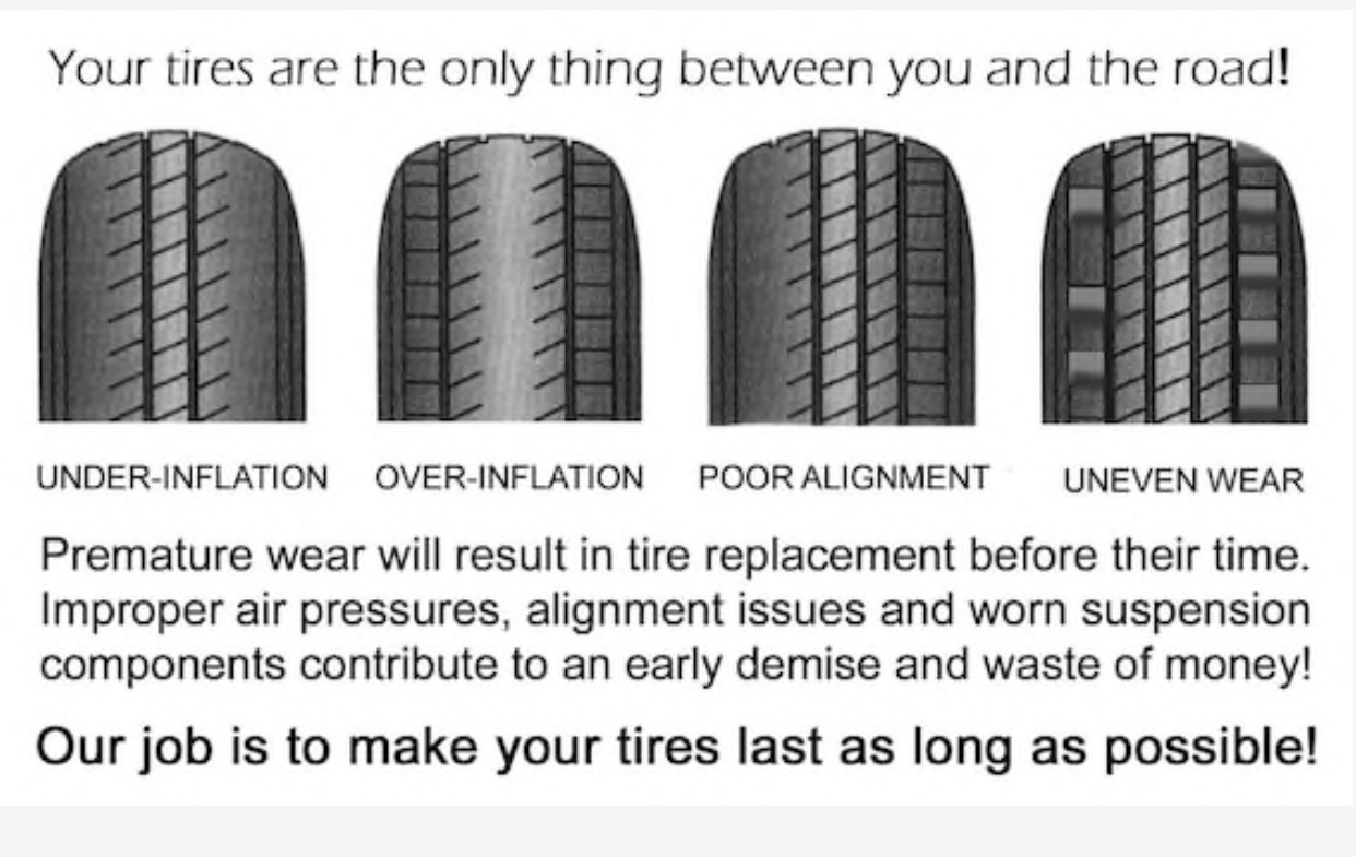

    Are you saying to inflate tires to 120 psi? Most tires I have checked on the sidewall have a rating of 110 psi (cold state). I have seen some steers with 120 psi (cold state), but they’re rare. Some people inflate at 110 psi, but I’d say they run the risk of developing problems due to possible over-inflation if tires were inflated in the north and then they head to southern states. (Image below).

    I read your comments, but I was replying about the 120 psi. I, personally, wouldn’t put 120 psi on a 110 max (cold) tire even if the tire was carrying the max load listed on the sidewall. The tire will probably hold, but may very well develop over-inflation tire wear (image below). Heck, I wouldn’t even put 110 psi if I drive regularly to the north and south states.
