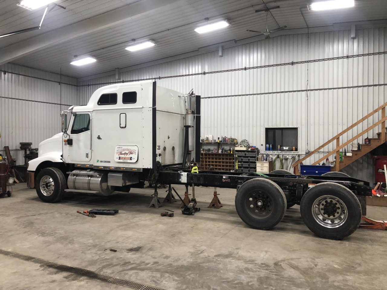

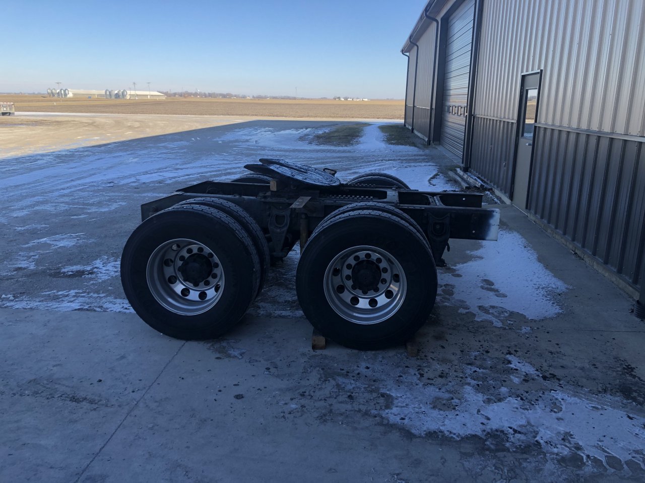

    Literally just put 3.08 and a 13 speed in my truck over the last month. I’m on my first trip now and absolutely love it!!!
    It had 3.73 and a 10 speed before. 12 is almost exactly what 10th was before.
    Added disk brakes too. there even better than the gears!! 91C10DC3-271C-4894-83EA-1B90CF3AC508.jpeg 2C8B0BD8-0EB4-4E65-8DA1-4B49F4457EBB.jpeg
