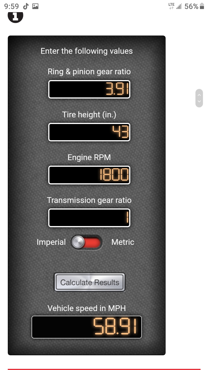

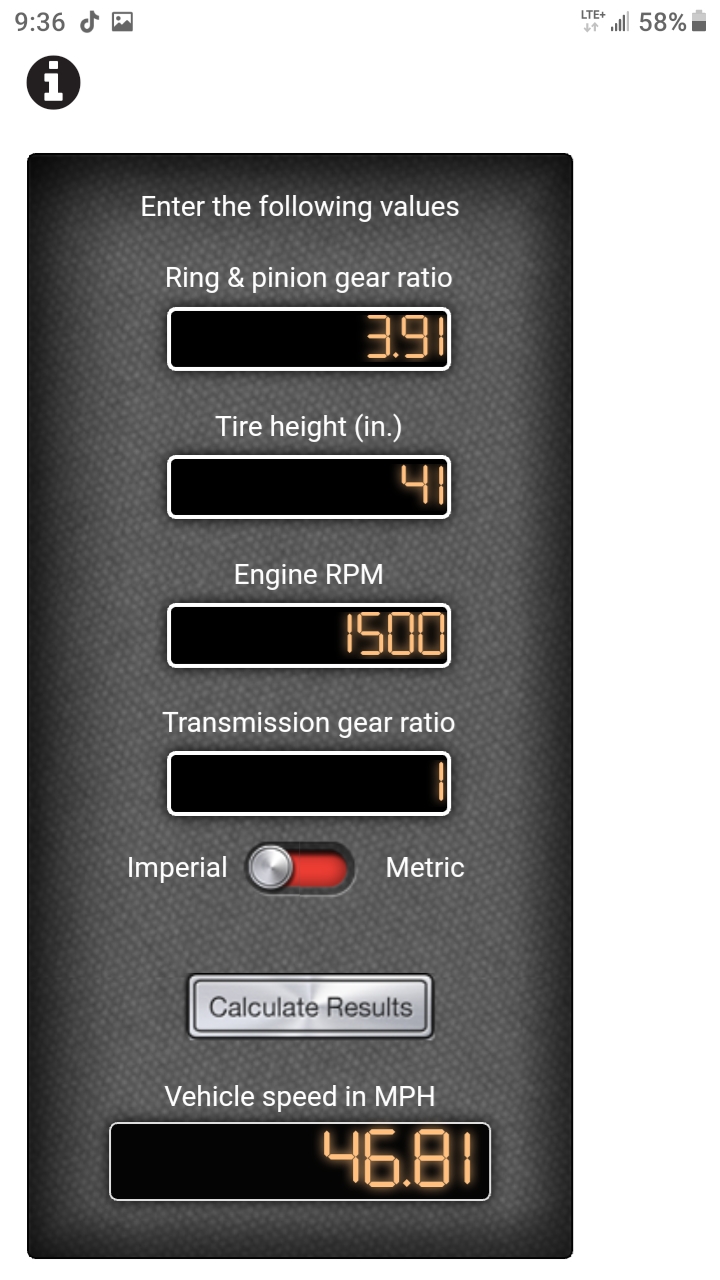

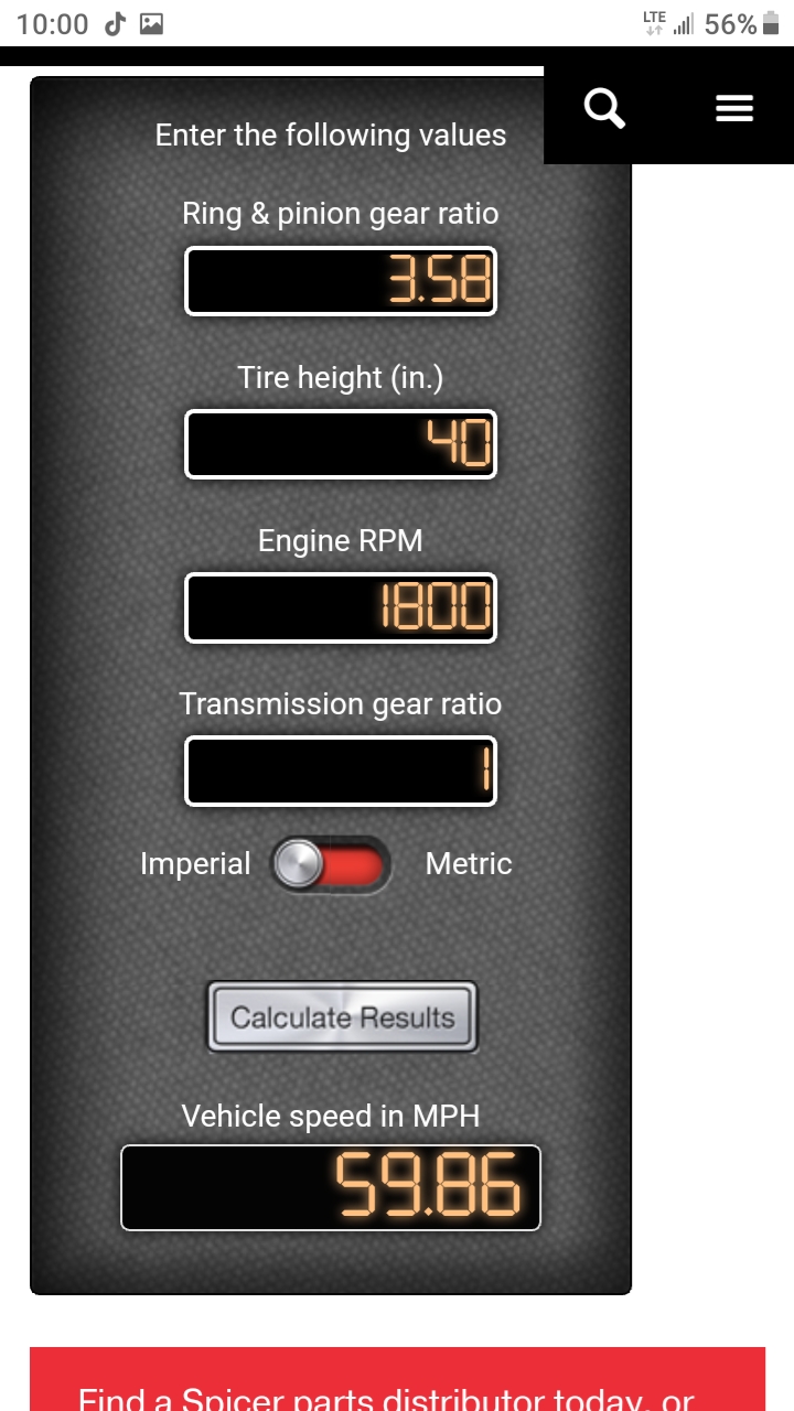

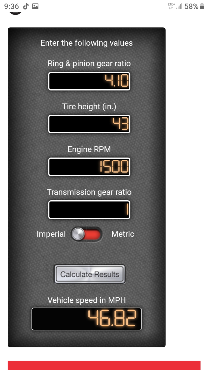

    Go to this site..
    Transmission Ratio RPM Calculator | Spicer Parts
    Tall 22.5 3.91 is exact same effective ratio as tall 24.5 4.10..
    3.58 is pretty far off from a 4.10, but off by maybe 2.2mph tall rubber 3.58, 22.5 to 3.91, 24.5..
    Now 3.58 with lo-pro 22.5 is pretty close to 3.91 tall 24.5

    You want to run one of them 63,500kg (140,000lbs) Canadian jobs in the mountains with 3.58's.? :eek:
    I'm just a 4 axle silly flatlander out of FL, but that sure don't sound right too me.. 4.10, maybe even 4.30's is what I'd be looking at depending if I went tall 2's or tall 4's..
