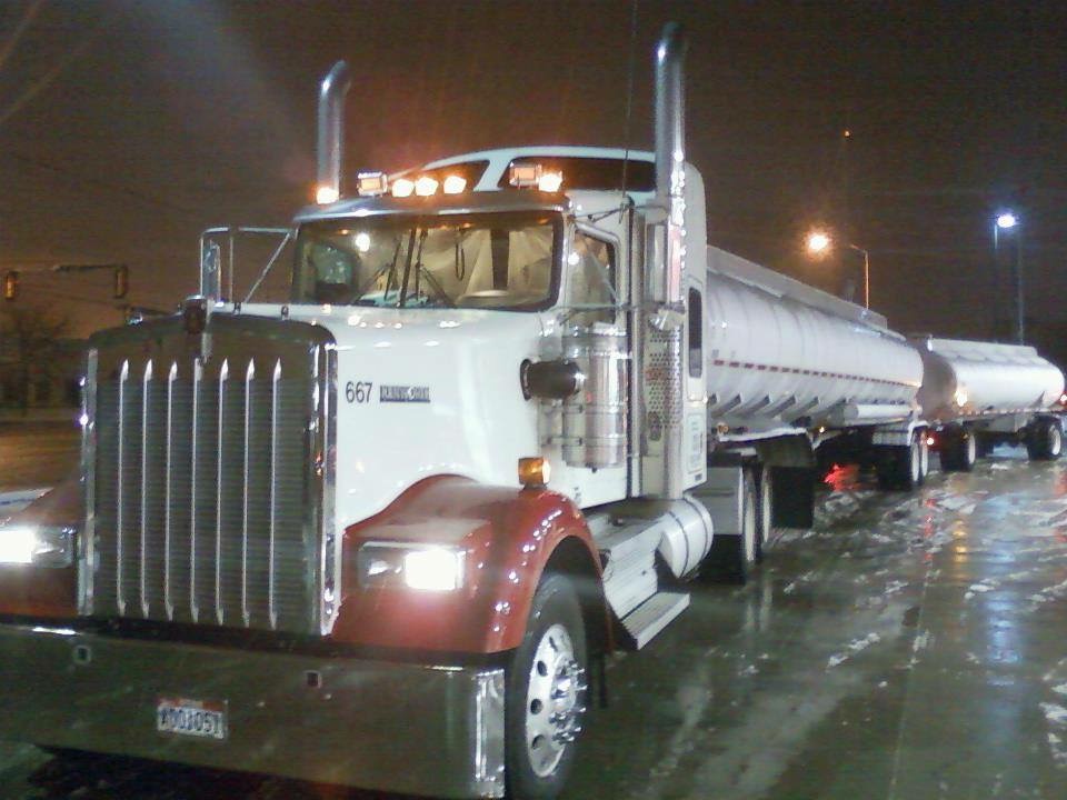

    My first day pulling a tanker train . They handed me the keys . Dispatcher said ' we don't train . If you can't do it we don't need you . ' lol image.jpeg sometimes you just have to have grit
