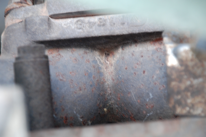

    Saw this first hand with two trucks. One was mine. Hole in the exhaust manifold. Here's a picture of my crack. (That just didn't sound right)

    We are starting to get personal I see on this site, I understand we are a bunch of lonely truckers but its not right for one man to look at another mans crack my friend. They have a cream for that.

    Ex manifold in new. I just replaced middle section with new holset turbo due stripped threads. How about piston pin ?
