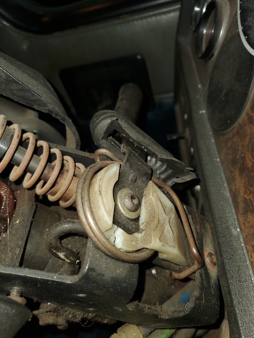

  10. skallagrime
    skallagrime Road Train Member
    3,855
    9,929
    Apr 10, 2012
    Indiana
    Take cover off, its possible you have only one, (was sourcing a new column for my 94 kw, i can get fixed, tilt, or tilt+tele) see pic, my telescope cam is shattered, so now i only have tilt... except that also requires a screwdriver to help it...
    Rideandrepair and 04 LowMax Thank this.
