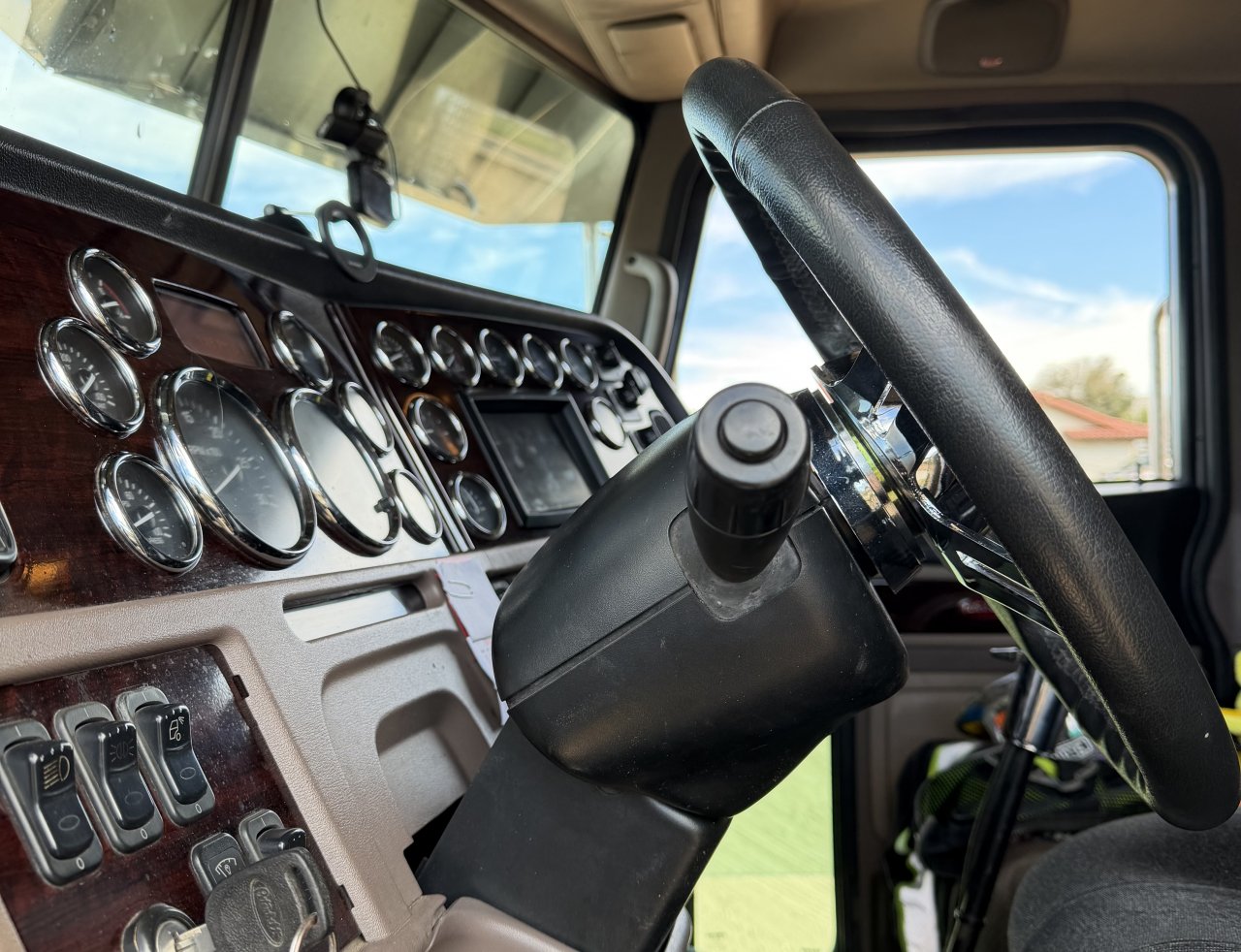

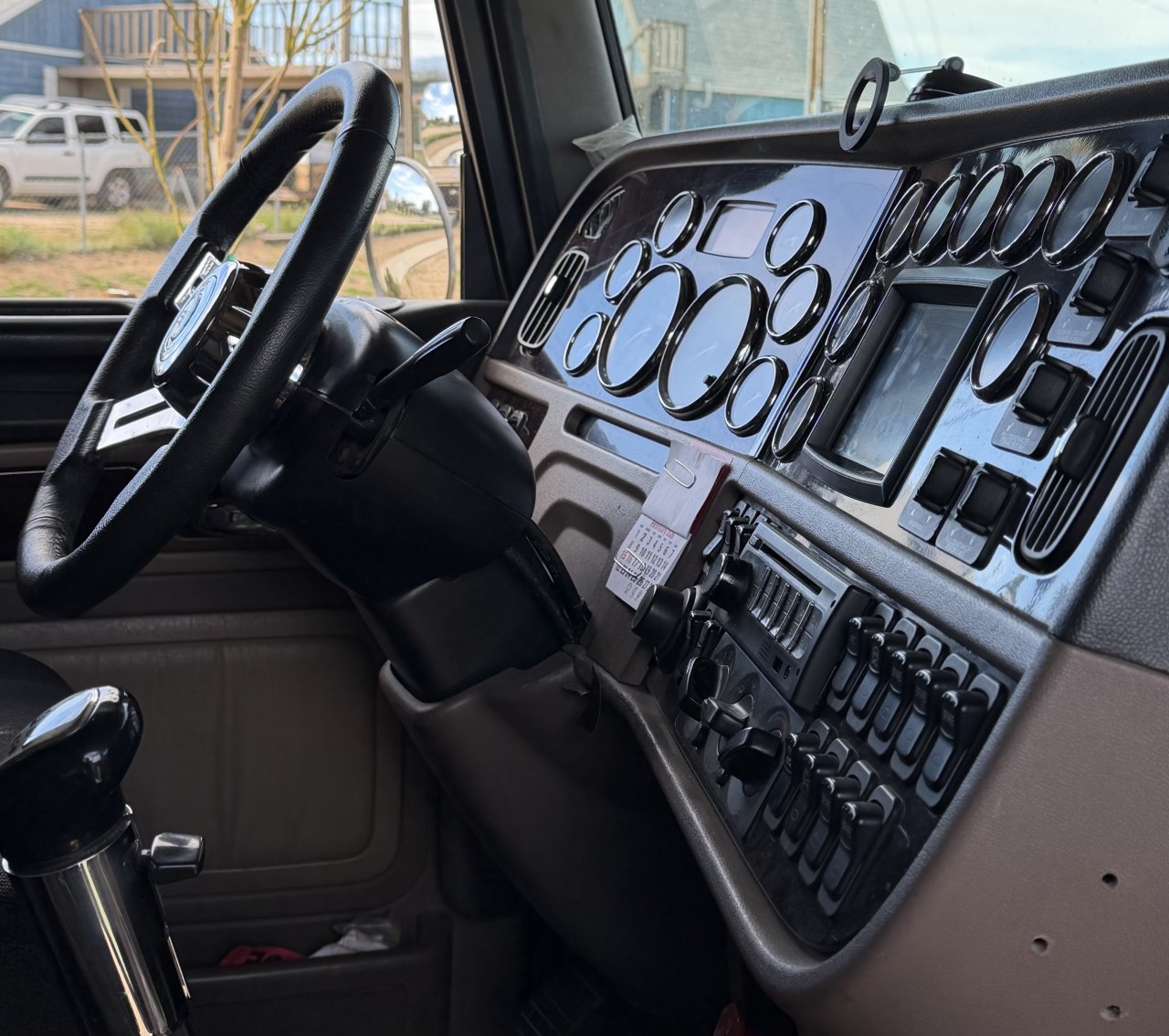

    Reviving an Old THREAD;
    Today I decided to remove the stopper from my 2014 Steering column so I can have that lower tilt drop. It all started when I searched on YouTube to replace my OEM steering wheel to a 16” diameter. Seen some clips along the way to get that lower tilt drop, figured I’ll get to that on a later date. Today was the day, removed 3 column panels, drilled the white stopper in several spots, and chipped away. Done. IMG_8565.jpeg IMG_8564.jpeg IMG_7574.jpeg
