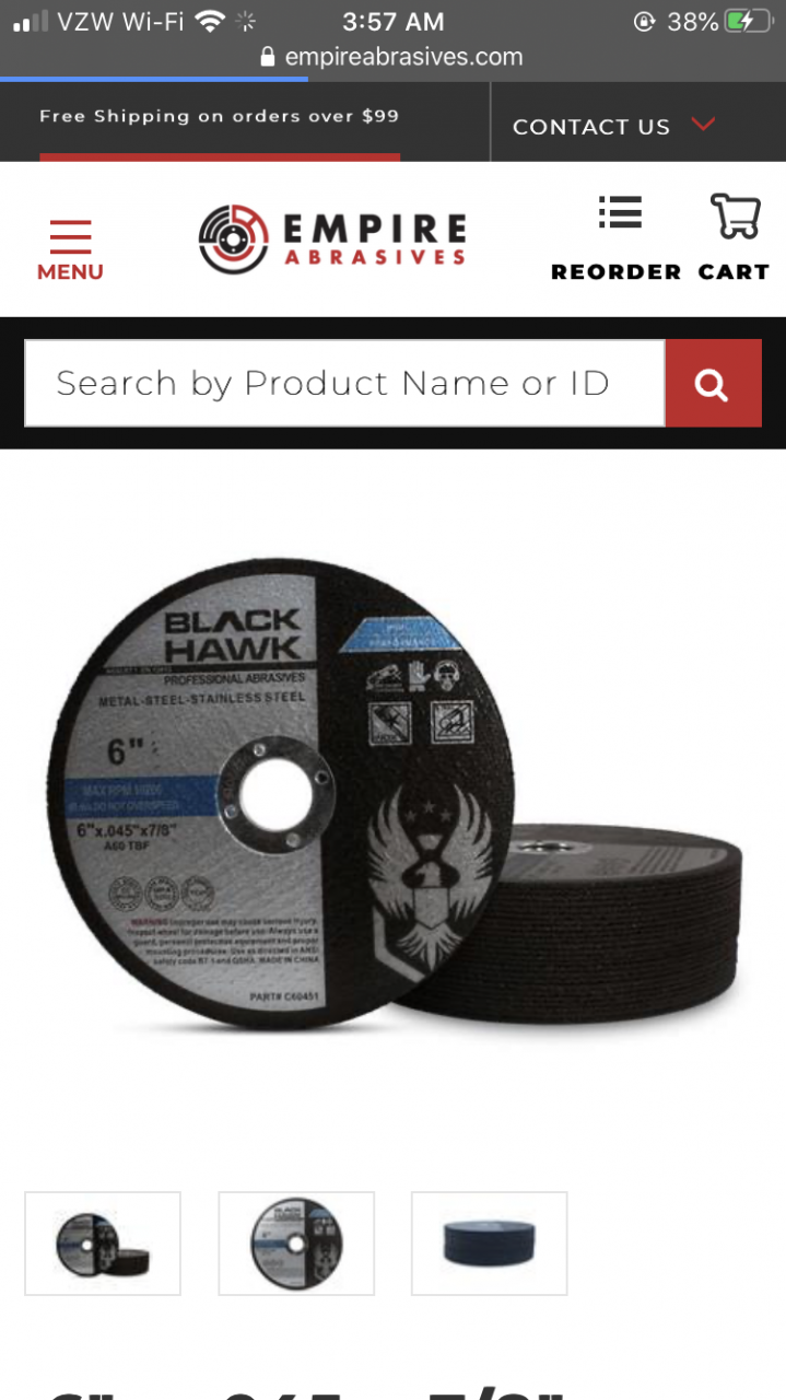

    Cutting straps. I have a chop saw with a carbide cutting wheel on it. Set a mitre box on the table, then stack a bunch of strap in the box. Then cut with wheel. It does not cut so much as melt it’s way through. Leaves a nice clean edge and won’t fray.

    Might want to post a picture of how youve got that set up. running a toothed saw at a strap is a fast way to donate blood and destroy a tool in the process.
    (Not disagreeing with results, im just not picturing how youre doing it)

    Wheel vs toothed blade makes the difference.

    Ahhh, gotcha, i was thinking carbide meant tipped, derp

    That’s what I’ve seen Profesional rigging shops use to make custom straps.

    @Ruthless covered it.

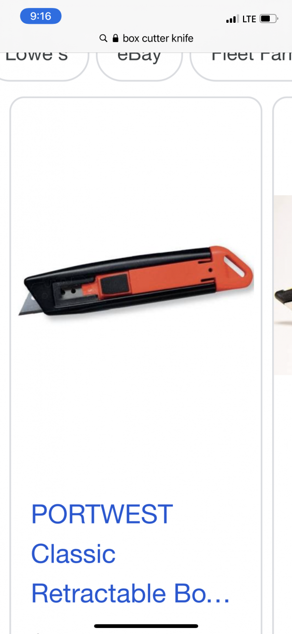

    2002B163-A399-4CDA-9088-0CDEC52A3B5A.png Box cutter works just fine also. Then singe the ends so they don’t unravel.
