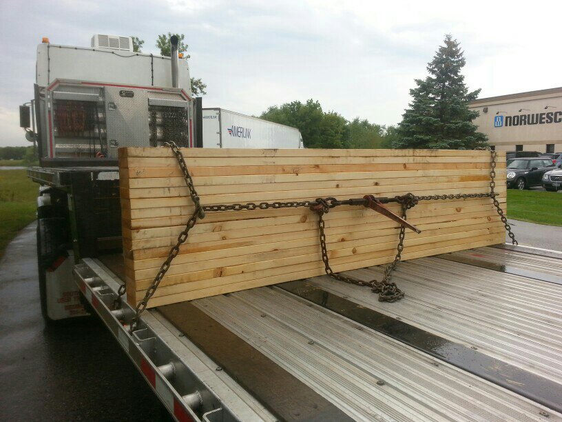

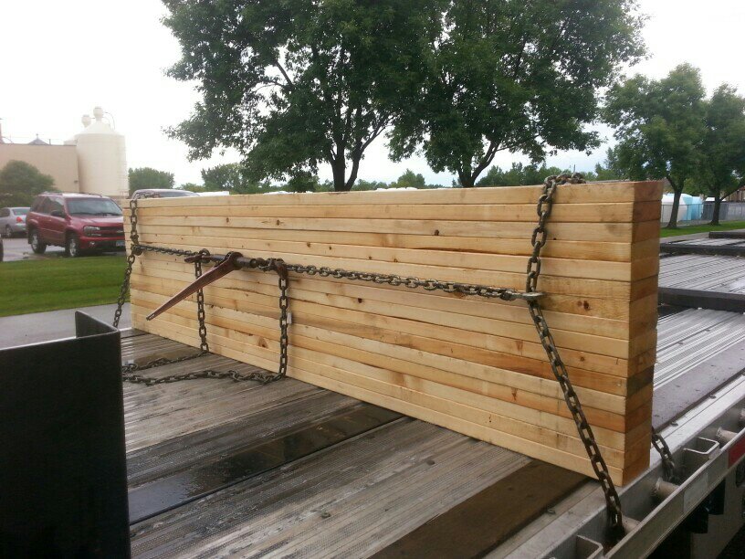

  11. dannythetrucker
    dannythetrucker Road Train Member
    2,856
    4,032
    May 26, 2011
    everywhere, man
    Load leveler. Kind of hesitant to post this, if you do it wrong or use for the wrong product you could really screw something up. But for the load I picked up today it worked great and I have a project at home to use the 2x6's on so really not out anything.[​IMG][​IMG]
