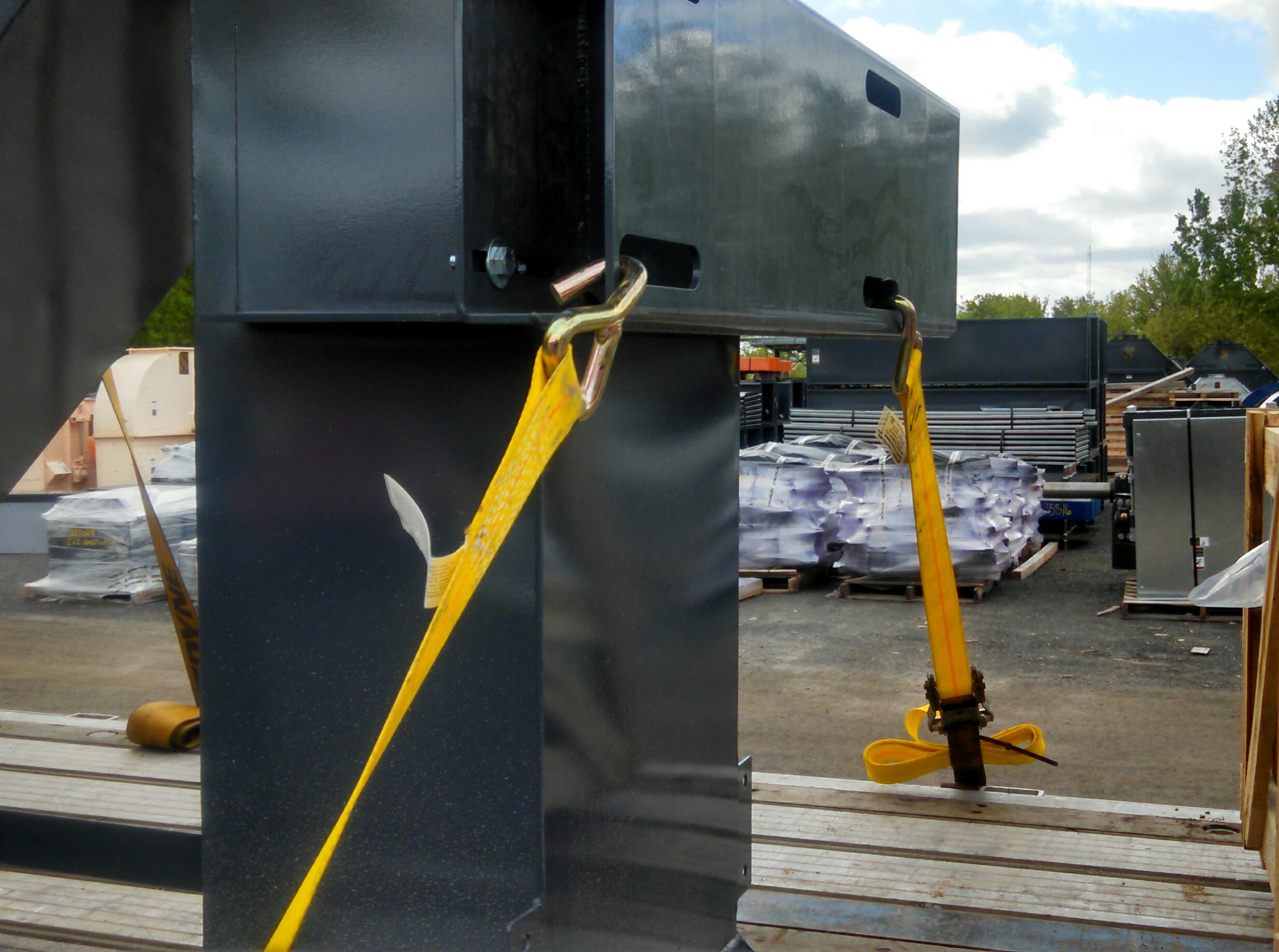

    Awhile back i posted some straps i had made for me. This is what i use them for. IMG_20150512_150850_211-1.jpg
    barroll, Lepton1, Ruthless and 4 others Thank this.
