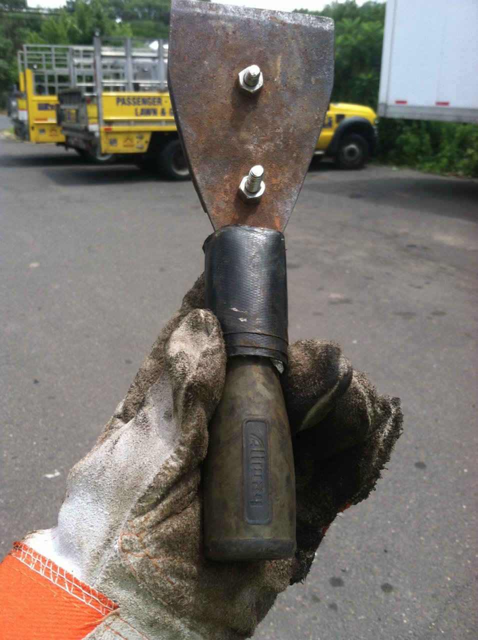

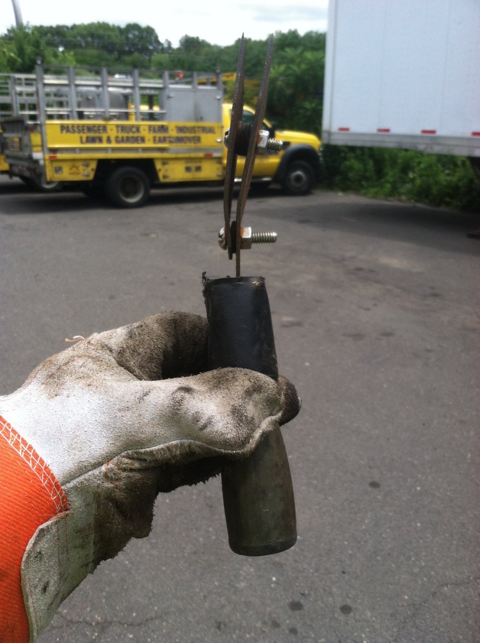

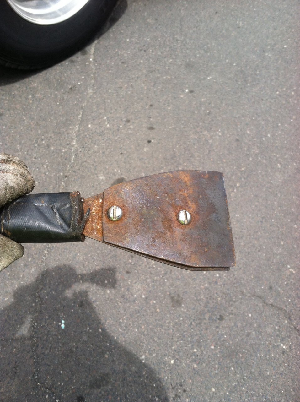

    This setup screws onto an extendable painters pole 6'-10' maybe.
    Can set edge protectors in between the blades
    Bottom screw I hung out the same length, can use it to hook and pull back straps over a high load, edge protectors that slip a touch too high up and over. Or to rip tags from up high on blind shipments.
    Took two scrapers, hammered the end off one n cut it. Punched 2 holes with a drill. Put 2 bolts thru, with washers between top one to gap it right.
    Voila
    Also I ripped off the base on handle end of the painters pole and put a steel plumbers fitting on it with epoxy-use it to hook chain ends and push them thru longer expanses of where chains go.
    It's just like a open end rounded nut with a lip on the inside.
    Works out purty good

    Rankee extendables. Has several different attachments for their telescopic pole. 30 bucks if i remember right. The 3 attachments i got was the strap and edge protector one, a grab hook to pull chains through reels, and an adapter so i can spin on a push broom.
