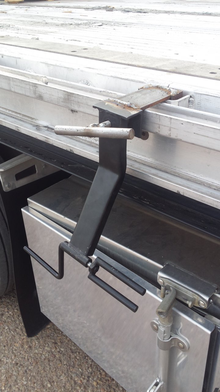

    That's pretty sweet. Been looking for a similar setup as I bought a winder but cant use it pulling a Conestoga. I had the same idea with the stake pocket post.

    A former flatbeder at my barn made it up for me out of scrap and a chunk of c channel. Works like a dream, no twist locks to mess with, just move in from pocket to pocket as i unstrap

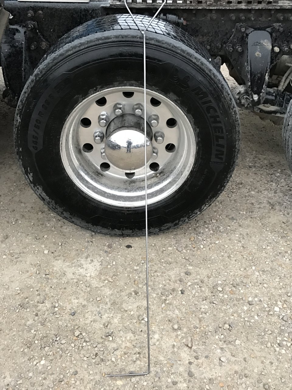

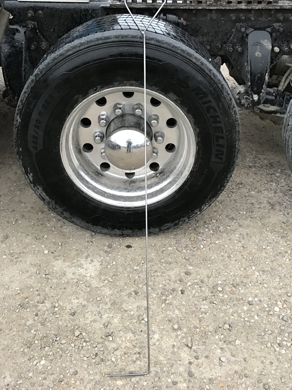

    If I get a chance tomorrow i'll take and upload a pic of an alternate tool I use for fishing chain and hanging up edge protectors instead of using a fifth wheel puller. Made out of 1/4" round stock. got a 6"x"6"x6" triangle for a handle, 4ft of round stock and bend the last 6" into a L. Its pretty light. If I had to do it over I'd probably use something a little thicker for the steel round stock.

    Some tips for making yours. Get c channel that fits pretty good in your stake pockets. The c channel my guy used is a bit smaller then the pocket. I think a snugger fit would be more stable. Also make the c channel go all the way down to your gasket.
    I think with those two alterations I wouldn't need to screw it to the rail.

    IMG_1474.JPG This is the pokey grabby tool I was referring in my above post. Comes in handy for short people like myself when your at a unload and not allowed on the flatbed. The triangle helps balance and put edge protectors up. Not bad for 6 bucks.

    We make those out of all thread rod, a few dollars for a 6' peice, use the rub to bend it up, like this winch winder, dont use it on my current truck. (Winchs are to deep set) and i dont keep my straps on the winchs on my 48'.. but it works well
