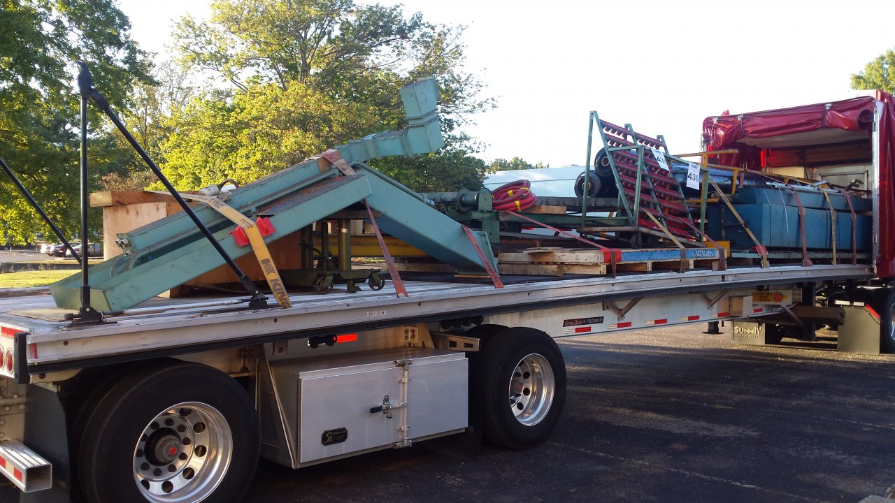

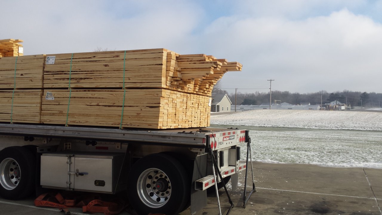

    They are the tensioners for my rolling tarp. You can see them installed in this picture. They come off so they don't get destroyed by bad forklift drivers.

    Ahh didn't see the tarp system in the last pic. You spoilt lil ####. I'll be thinking of ya next time I'm lugging my 8 fters.
