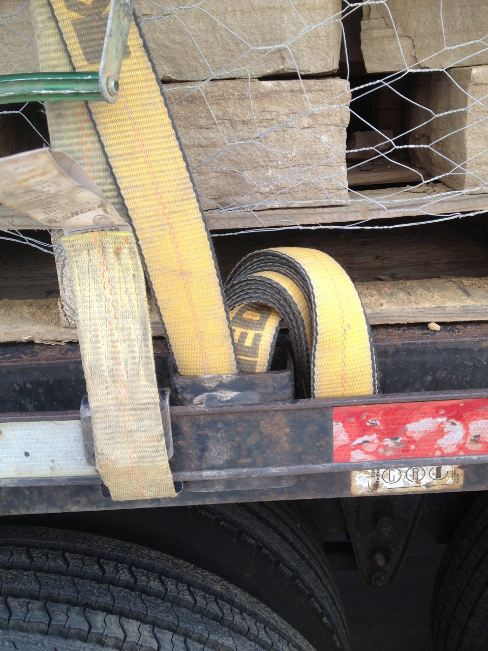

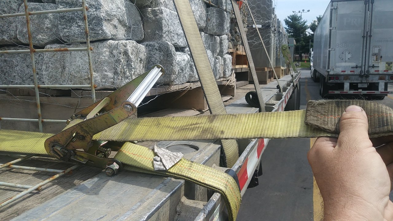

    If you put just the slightest amount of effort into short strapping you can get the fold through both sides of the winch. Just pinch the strap down before you put it through the winch. Even works with hand ratchets. On this load I had 8 hand ratchets and really only needed about 10’ straps but I had mostly 30’ straps. Short strapping the had ratchets made loading and unloading much faster. BB1DD2C3-C93F-4F08-8D05-3F1E52517C94.jpeg

    After taking a break from driving, I can't get my straps to go through both sides...what's the trick?

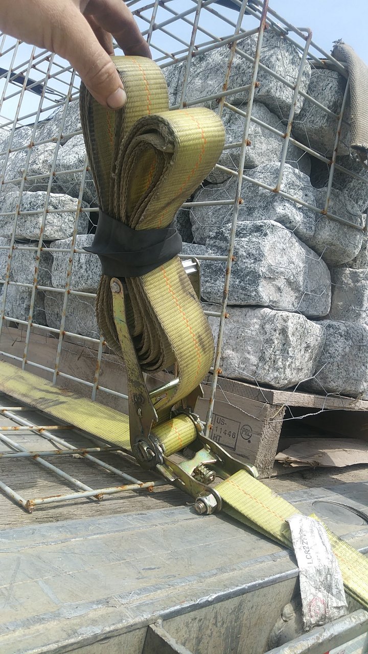

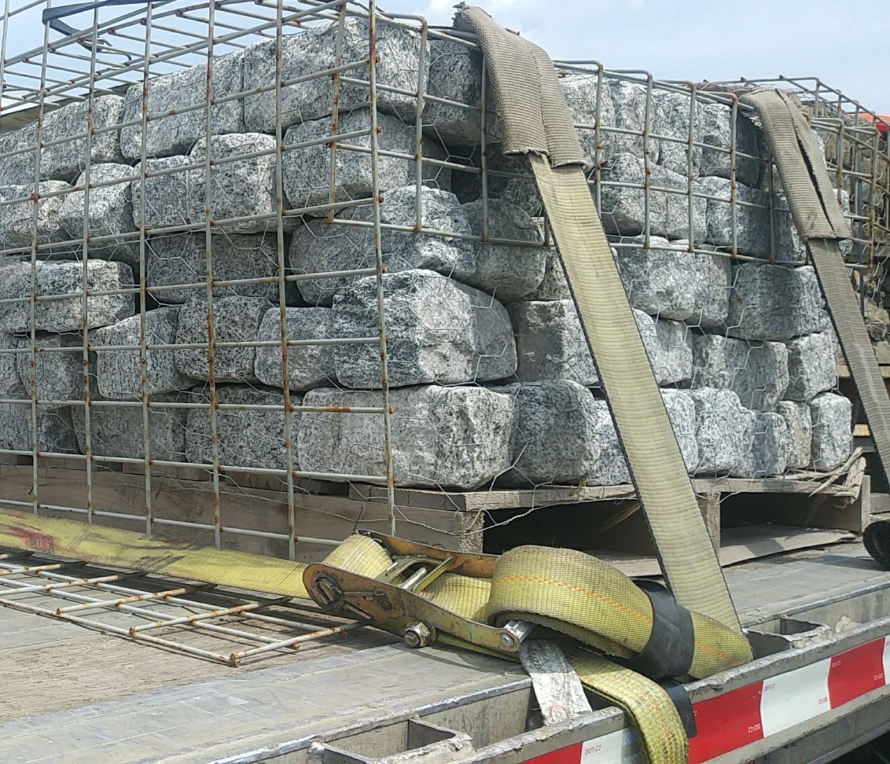

    Some cobbles shifted and i strapped 2 screens in front just to be sure it didnt bust the basket. This is my goofy 2" tail job.
    The rubber band is just inner tube and you dont need to do anything to tighten the strap. Never had one untuck from the rail.

    Fold the strap and pinch it between your fingers working it back and forth. Or take your winch bar and tap the fold flat against the rub rail. If it doesn’t go through both sides right away I’m fine with just one. Never had a strap come out of a winch either way.

    What he said. A lot of times my winch slots are full of ice and it barely takes any to hang it up on the off side, and if you get a couple of wraps on it, it is impossible for it to come out of just one anyway.
