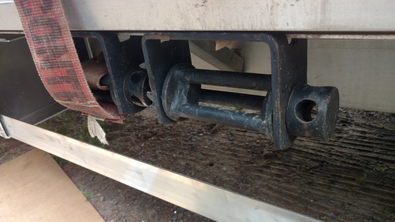

    3 bar winch. Fold your strap in half, shove it all the way through. Worth there weight in gold when you got frozen fingers!

    That is the ones I like the best, especially up here in the frozen north, but I pull a lot of different trailers, so have to work with what is there.
