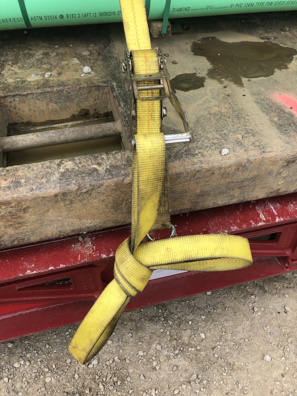

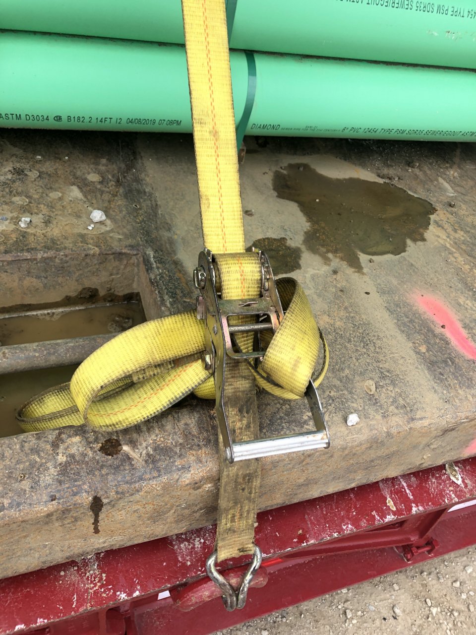

    I’m shut down for the weekend do to oversize restrictions. So I put your theory to the test. I have a strap over the loose part of my half assed trap job of an empty crate. It’s short strapped and what I consider tight and haven’t touched it in 2000 miles.
    I got my long bar out of the headache rack, which I almost never use because a short bar gets straps tight enough.
    I was able to get 4 more clicks out of the winch and could not get anymore with a 4’ bar and almost 300 pounds on the end of it. Here are the after pictures. Strap never slipped.

    The only way you can get one to slip is if you did not leave enough slack in it when you fold it. It is not brain surgery and anyone can easily see it is as safe as the other method.
    Like someone else mentioned earlier, they will slip when they are all the way through when they are to short to get a wrap on them. I have pulled, tugged and fought the hell out of a strap when it was too short to get enough slack to get a wrap on it several times over the years.
    kylefitzy Thanks this.

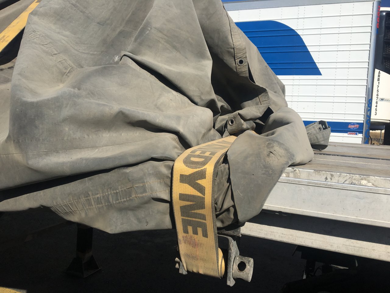

    Here’s how I handle the tail on a ratchet strap, I tie this knot and throw it behind the strap. It’s quick and simple.
