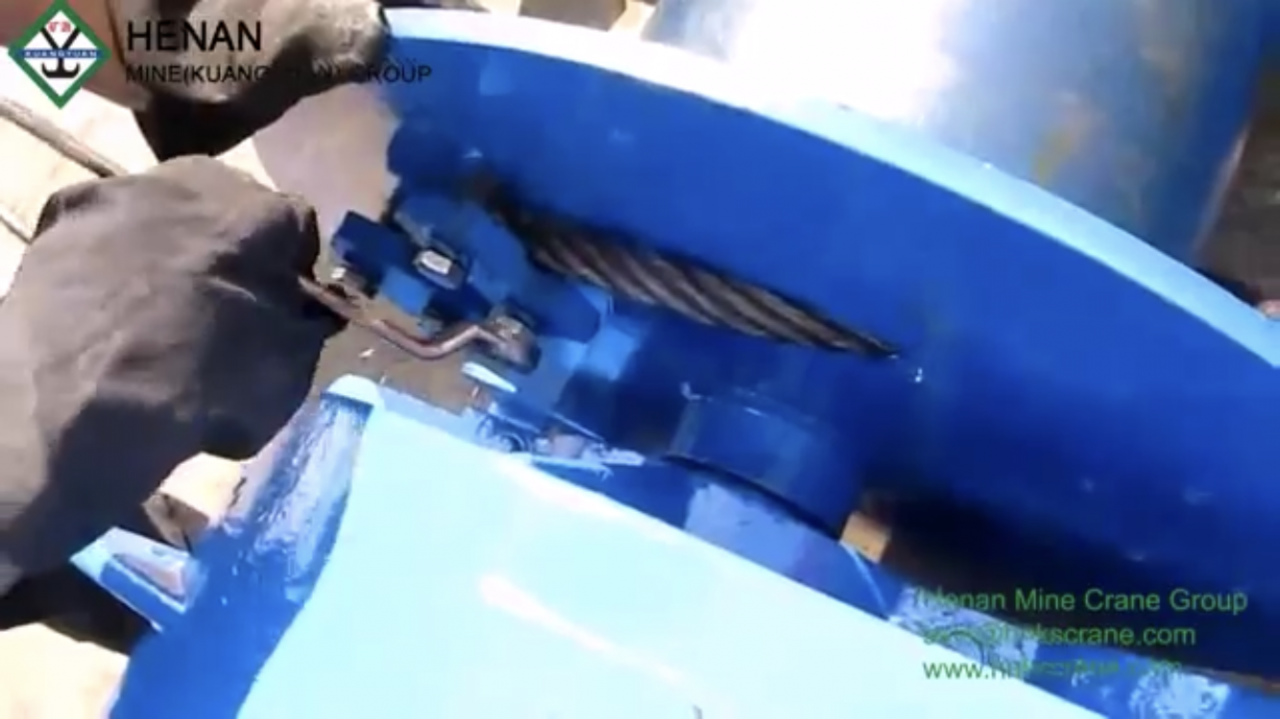

    Yes, that's what I said. I also said it doesn't rely on only friction. You want to ingnore the cable anchor you described as only wire? Why do they even have a cable anchor if it isn't important?
    The anchor desnt hold much tension, it certainly isn't holding th load, but it's there for a reason!
    Same thing with a strap winch.

    It’s there to keep the cable in place until the requisite amount of wraps are on the drum. You can take the bolts out when it’s reeved and it will stay. I’ll ask again, have you ever reeved a crane?
    Look the horse is dead, you seem to have had trouble and you think because of that it’s a problem for everyone. You’re hypothesis does not defy physics.

    Yeah, why even use and anchor on the crane cable... Just stick the tail under the next wrap of cable. Then the next wrap will do more to hold it, and so on.
    Why does the strap winch manufacturer specify not 6" but 12" of strap that needs to be put through the winch? Even when it works on the same principle of cable on a crane cable.

    Cover their rear end just like any other company does. Still doesn’t defy physics.
    Look man you’re in the bottom of a hole and still digging, that’s on you.
