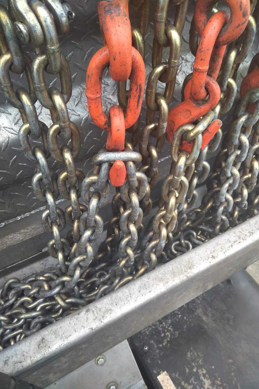

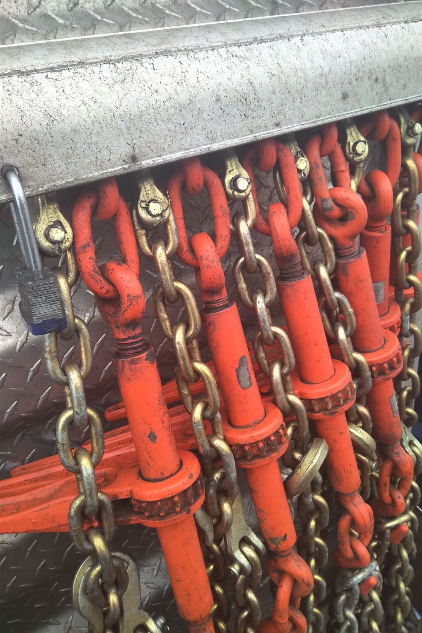

    Well i been meaning to post this for awhile. Had an old timer show me a cool trick runnning a open heache rack. If u hang ur binder and chains . One after the other as in order: binder chain binder chain etc all the way til the end and then take the end of each chain and hook it to the bottom of the binder hook it keeps the bottom hook from spinning out and falling into the deep depths of headache rack hell.
    I have been testing it out for a month or so and it works really well , keeps it from spinning out. Cool trick , and thankful for the old hands to pass down the info and help another driver out

    Yeah i used to do that as well. Just get lazy with it after awhile . Running my chains and binders alternating each one seems to keep the chains from getting tangled as well , i started outside to inside so when i pull them out i start from inside to outside. Keeps it nice and neat thanks for the tip ,always looking for new ways to do things
