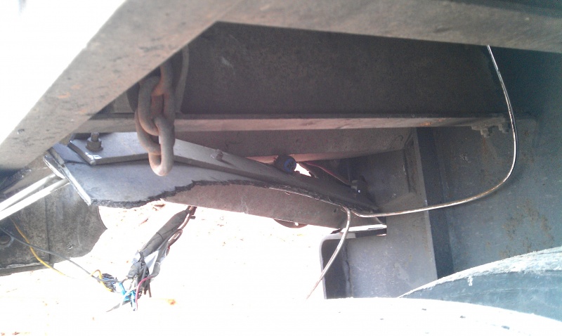

    This morning had the worst tire blowout, stopped to check it out and found out that the tire had caused a lot of damage to the rear.
    What are some off your worst tire blowouts?

    That looks pretty typical. Figure a LP 22.5 tire spins around 524 times per mile...at 64 mph, that is 559 revolutions per minute....a little more than 9 times per second. The tire also weighs in excess of 100 pounds, with a lot of that weight in the thicker "tread" part of the tire. When the tire starts coming apart, it's swinging a nearly 100 pound chunk of steel-reinforced rubber around 9 times per second, which will destroy pretty much anything it makes contact with....fenders, mud flaps, air lines, etc...
    Factor in the extreme pressure the tire is under (100 psi cold....increasing as the tire warms up) and you start to understand WHY it is absolutely stupid to tailgate or ride next to a truck.

    i had a rear inside drivers drive blow. i had a one piece rear light bumper along with the middle frame light plate under it frame gag cover. it took all of that out along with the wiring for the lights my air hoses for my trailer since i had moved them to the underside of my flatbed. also took out the outside drive and both airbags about 4 grand in damgae.
    What pissed me off was this was a new tire i bought at the TA truck stop because i had a tire that got a slice in it and got nailed by a dot cop. didnt get a ticket for the tire. he followed me to the TA and watched me put in the work order. The tire was some cheap knock off and when we had it inspected the found that the tire had a bad mold cast and the liner was leaking which the said cused the blow out so one load 2 tires 2 air bags 1 light bumper 1 frame light bar and 1 frame gap cover....good was all the led lights survived and was able to put them in the new parts....

    blew drive and the piece hit my fuel tank. dented it real bad and the wires in the reinforcement scraped it deeply. like claws,thought it was gonna leak.
    Oh, and SK27 you are gonna change that flat spotted tire, right??
